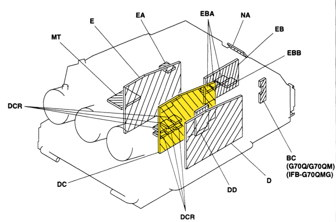

Not to sound any dumber than usual, Which one is the DC Drive board ?

Posted: Wed Apr 06, 2011 10:45 pm    Post subject:
DC = Convergence on the g70. If you pull it out you will see the letter DC inked on in White.
There's some Sanyo chips on there that fail but Curt can upgrade these with more robust chips that will not go bad. The chip is the big black thing the red arrow is pointing to, there's 2 of them

Posted: Wed Apr 06, 2011 10:54 pm    Post subject:
DC board location...
