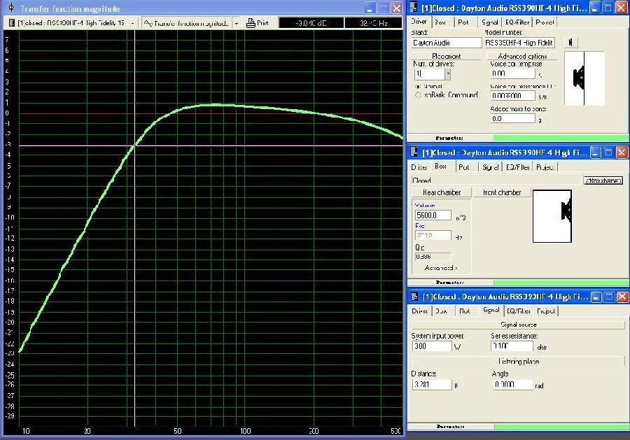

Posted: Sun Apr 17, 2011 11:40 pm    Post subject:
Hi Steve,

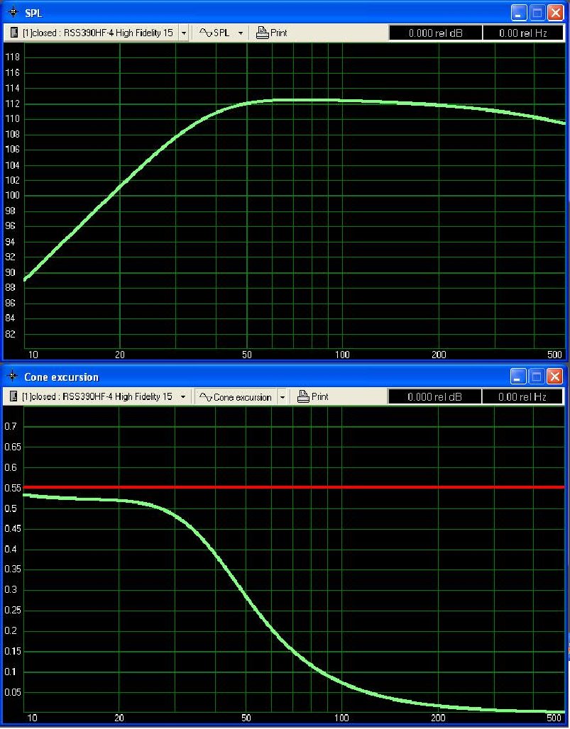

Ok, I just plugged in the info into WinISD Using:
1) Dayton Audio RSS390HF
2) Box info: 1 Driver per box, sealed configuration, box volume (after bracing) is 5600 in^3
3) 300W amplifier per each box.
The frequency response is very similar to the 8167 in^3 boxes. The -3db rolloff is still at 32hz.
Using the smaller (5600) box at 300 watts (max), the Xmax (cone excursion) stays within limits. So looks good there!
...but it is really moving at 30hz and below.

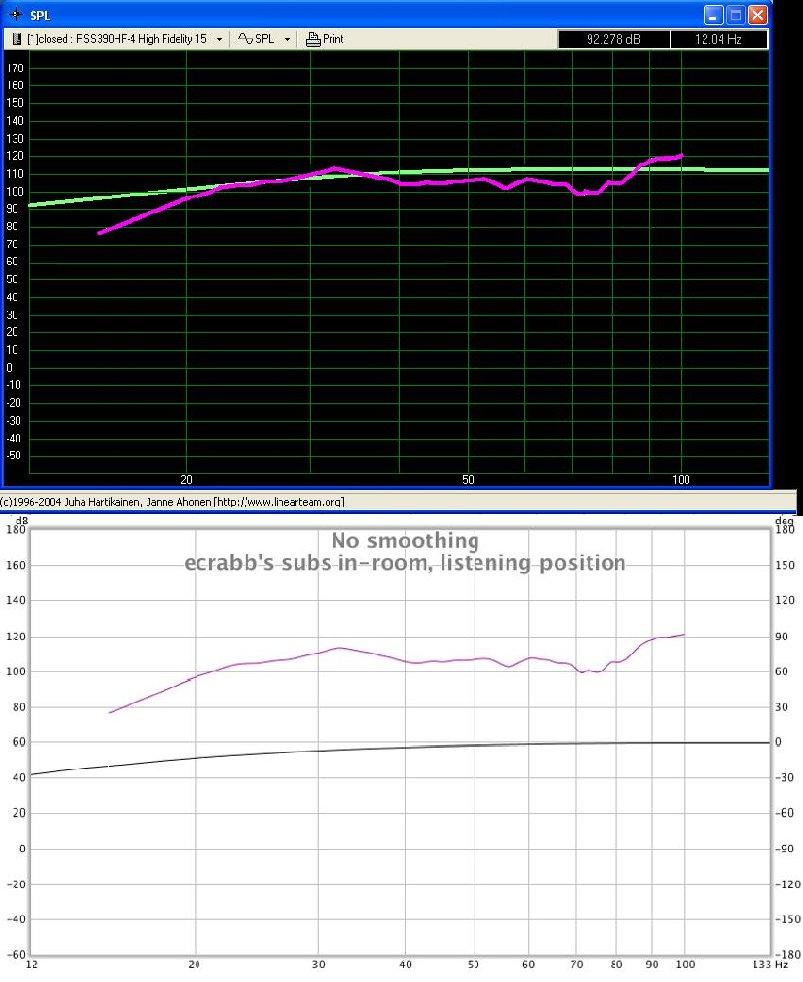

Just out of my curiousity, I compared your REW readings to the WinISD model. The two are really close, and illustrates the slight driver/room interactions.
It shows (to me) that the WinISD model is fairly accurate to real world results.
...Although, when you did the REW reading - did you only use (1) sub for the reading, or both?
The results are right in line for (1) sub, but doesn't show the +3 db increase ***IF*** you used (2) subs. Imagine the green line moved up 3 db.
(Ok, wait a minute. Due to the magnitude of the Y-axis scale - it wouldn't move much. So nevermind.)
Summary: 32hz F3 rolloff, approx 108db down to 32hz, (-7db at 20hz, ouch!).
Building two boxes will not help the F3, but WILL increase the SPL.
Total costs for ONE sub is:
$160 + $150 + $50 = $360. (1-Driver, 300W Amp, and Wood)
+ $40 for topcoat = $400 (Or leave it bare if you don't care)
+ labor ($150) = $550 total. (Your time and cost may change)
So just like you said, you could build one for $400~ish if you don't count the labor. Or even cheaper if you find the equipment on sale.
