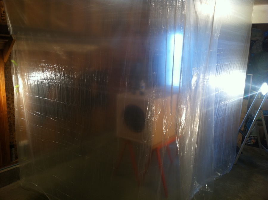

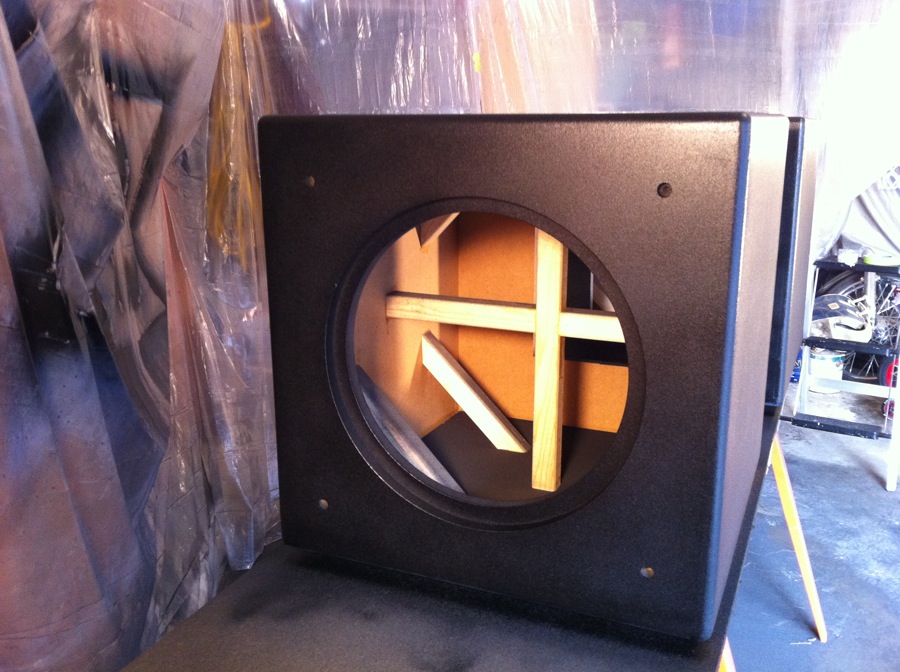

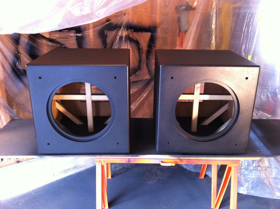

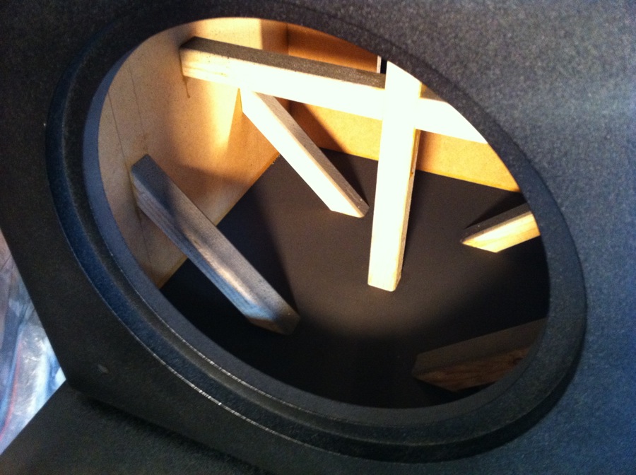

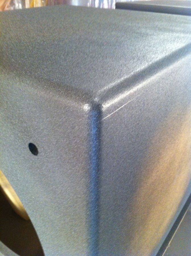

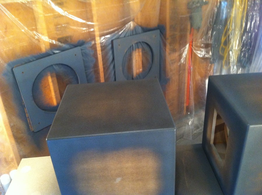

Finishing... Definitely some lessons learned. #1: Don't try to use rattle-cans to spray something this size. They turned out pretty damn nice, but damn... Probably nearly $40 worth of rattle cans. Should have taken a photo of the PILE of overspray I swept off the floor. Can you say waste?
Makeshift spray booth
Primer
Texture coat
Coat of black
Baffle in black... Yeah, that's overspray in the bottom of the sub. Shocked
Drying. There's a little mottling from uneven coverage, but I don't think you'll ever see it in the theater even with the lights up.

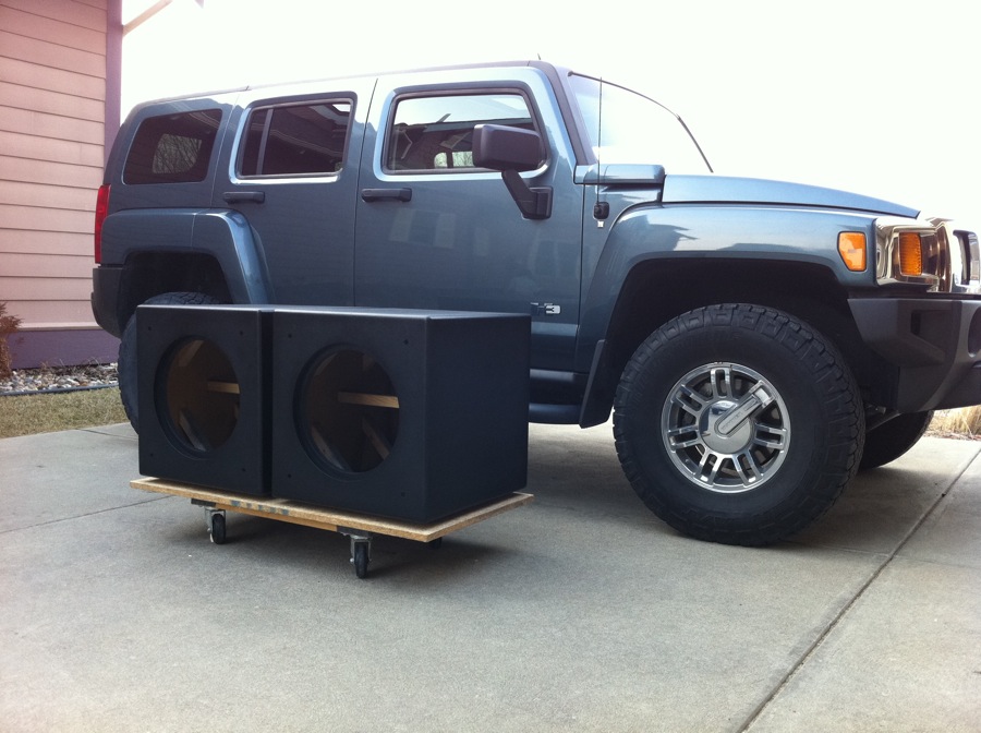

Size reference. Yeah, they're kinda big. Wink I think I'll call them "the twins" in honor of Art and Cliff's stack. This is probably as close as I'll ever get. Wink

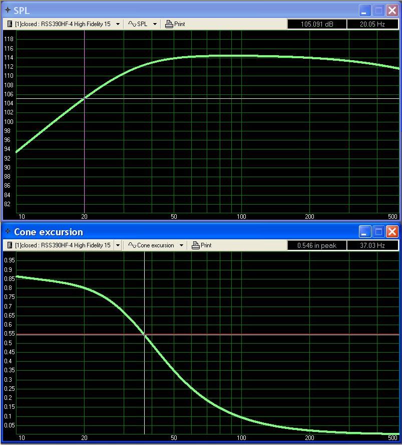

So, Let's look at what we've got so far...

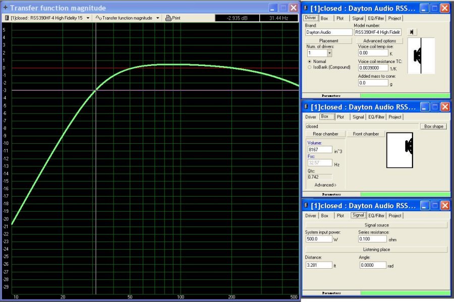

The given hardware:
1) Dayton Audio RSS390HF
2) Box info: 1 Driver per box, sealed configuration, box volume (after bracing) is 8167 in^3
3) You're using a 500W amp per each box.
See pictures: Dayton single -1a and Dayton single - 500W.
We've got decent flat frequency response, with -3 db rolloff at 31 hz.
The max SPL is 114 db, with 105 db @ 20 hz - Driven at 500W,

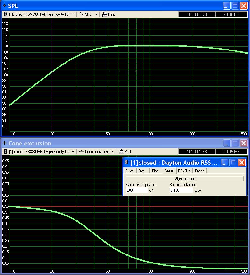

As stated earlier, at 500 watts of power the speaker cone excursion exceeds manufacture limits at 37hz and below.
So the speakers are unusable below 37hz (at 500 watts). This requires active equalizer limiting, box size modification, or lowering power input to a lower wattage.
To keep the cone excursion within factory limits, the power amplifier needs to be reduced to about 200 watts.
This reduces max SPL to 110 db, with 101db @ 20hz.
See pictures: Dayton single - 200W.
If you use two subwoofer boxes (kits), you'll get a +3db gain in SPL. So 113db max, and 104 @ 20hz.

Yeah, your measurements jibe with mine, and you're absolutely right... 200w is about the limit with the large enclosure volume. After testing the first sub, I confirmed your (and my) initial suspicion that the amp would easily push the driver beyond xmax with very modest power inputs... It was fine with music (presumably because there was no signal much below 30hz), but throw in Dark Knight, and it was obvious that I could use less than a third of the gain knob.
Note...
Since I'm sure some would question the choice of 500w amp, I thought I'd explain... I could have saved $70 per plate amp ($140 total) if I'd gone with the O-Audio 300w amp as opposed to the 500w amp. However, I felt the 500w amps were worth it - even though I wouldn't be using some of the power - for dynamic power headroom, to have in case I decided to do something different later, and because the 500w amp has a single-channel parametric EQ and sub-sonic filter in addition to the 300w amp's simple LP filter. I thought all those factors easily justified the modest additional cost.
Anyway, after a little testing, I did decide to go ahead and reduce the internal volume. The enclosure is just too limiting to overall output, and I think it would be very difficult just to calibrate to prevent over-excursion. So, in the first sub (the only one pseudo-completed at this point), I used some temporary filler to reduce net internal volume to the 3.5 cuft ballpark. In the second, I'll build a "wall" into the inside of the second sub to reduce overall enclosure volume down into the 3.5 cuft ballpark. If that works well, I'll go back and do the same to the first.
The reduced volume will give me additional power-handling (350w ballpark, IIRC) at the expense of some extension, but the subs should be easier to calibrate and I'll be less concerned with the driver.

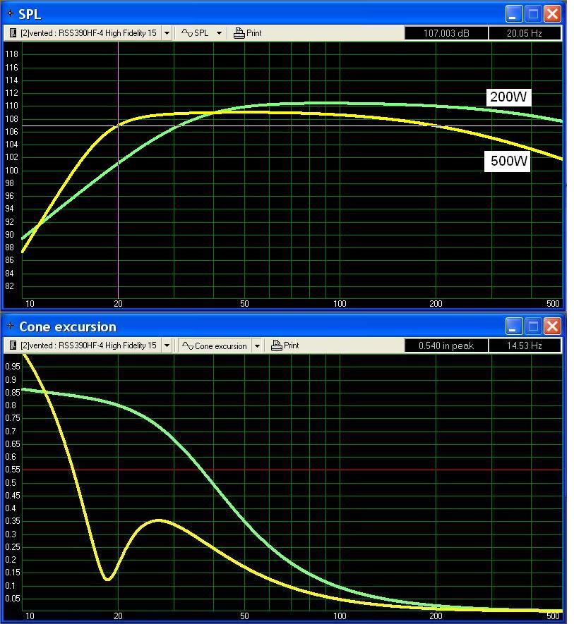

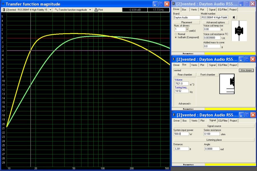

I was playing a little more with WinISD, and I came across a possible modification that will have some ***HUGE*** enhancements.
If you're willing to modify the box just a little more...
Modifications:
USE THE SAME BOX!

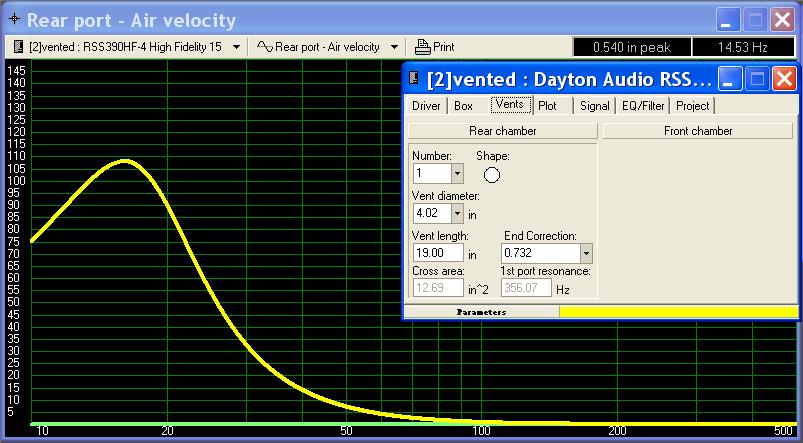

1) Box info: ** 2 ** Drivers per box (IsoBarik configuration),
2) Add a port 4" diameter x 18" long (tuned at 18 hz).
(This reduces the box volume to 7928 in^3 after bracing **AND PORT**.)
*I also subtracted the volume of the internal driver. That's why the screenshot is slightly different. It doesn't change the results either way.
Results:
See pictures: Dayton IsoBarik -1a, Dayton IsoBarik -2a, and Dayton IsoBarik - 4.
We've got decent flat frequency response, but now with a -3 db rolloff at 18hz. (ALMOST 15hz LOWER THAN BEFORE!)
The max SPL is 109 db, with 107 db @ 20 hz - Driven at 500W.
Speaker cone excursion is safe down to 14hz - which is well below required usage. ...And that's using the full 500W power amp.
The port air-velocity stays below the 110 ft/s - so very little concern about port noise.
NOTE: I compared the IsoBarik 500W with the original configuration 200W. I did that because this is a subwoofer project - and the goal is to get down to 20hz (and be safe).
The original configuration 500W exceeded manufacturer limits and was not a real bullet-proof solution. ...Well, not without special work-arounds.
Hence, the original configuration 200W was the "Safe" approach that I used for comparative purposes.
This IsoBarik configuration is safe for the speakers regardless of how high the amp is turned up to. (max setting? oh Hell ya!)
...No need for active equalizer, No limiting the power, No limiting input signal, No worries, ...All smiles...
Let review the original goals:
1) The design goal was flattest frequency response I could get.
-The IsoBarik provides a "flat" response similar to the original, but the IsoBarik drops the flat range by almost 15hz lower.
3) Preferred: Flat in-room response down to around 18-20hz at around 101-102dB.
-The IsoBarik provides 107db at 20hz. This meets, exceeds, and blows away the expectations.
...Oh ya, the best part:
You only need 1 box in the theater to get the same SPL. (@20 hz you actually get a GAIN of +3db!)
...And did I mention "Bullet-proof"?

Posted: Sat Apr 02, 2011 7:52 am    Post subject:
Nice....
With the IsoBarik configuration, you can install a 1000 watt amp - and still be within Xmax limits down to 16hz.
...totally safe. MAX power, throwing whatever you want at it - .... TOTALLY SAFE.
(@1000 watts) Max SPL is 112db, with 110db @20 hz.
The port air-velocity raises above 110 ft/s below 22hz - so you might have some port noise. But only during the really low-hitting notes.
But then again, with the volume cranked up that high - you may not ever hear it at all...
I guess you could just add a second identical port, and it's back down to 82 ft/s. (Way below the 110 ft/s rule)
But I'm not sure it's worth the hassle.
EDIT: the drivers have a max wattage of 800 watts (500W RMS). So maybe 1000W would be a bit too much.

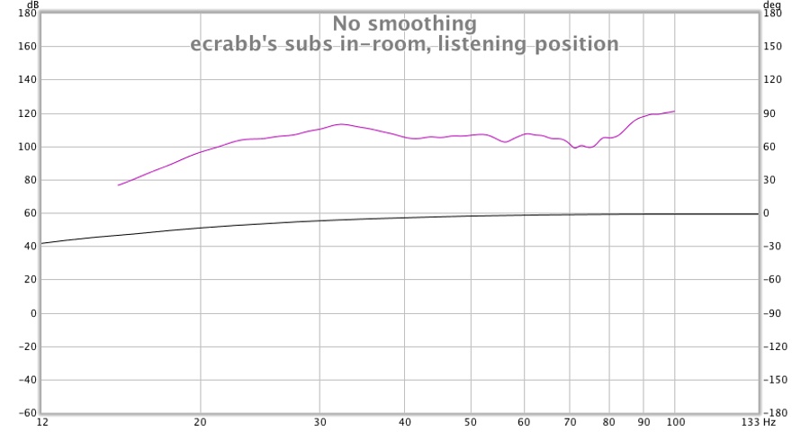

Posted: Wed Apr 13, 2011 3:57 am    Post subject:
I don't have time to go into all the detail right now, Paul... But, a couple of quick comments...
First, I wouldn't include labor in the prices... The reason is that this is a hobby - not something mundane. It's not mowing the lawn, cleaning the sewer line, or repairing gutters - it's something we enjoy... If you go down the "time is money" road, then a lot of DIY projects stop making sense financially. Even at a measly $20/hr, I can't even imagine what I "spent" researching, designing, and building my home theater!
However, in the case of the subs, I think they're pretty impressive even if you do include labor. Parts-wise alone, I had around $450 in each sub... Actually probably closer to $400. Since I'm only using half the amp's power, I could have substituted the O-Audio 300w amp for $60 less, or the PE BASH amp for even less, and put total parts cost under $350.
Now, the cheapest commercial sub that's even in the ballpark cost/performance-wise with ONE of the subs I built is probably the eD A5-350 at $800 shipped. 500w, ~4.7 cuft vented cabinet, -3dB point at 18hz... I don't recall the max SPL at 18, but I think I remember Ben telling me that 115-120dB in-room in the 25-30hz ballpark shouldn't be a problem.
Now, after getting these two subs running for the meet, I'm thrilled. I haven't done extensive testing yet - I just spent an hour or two playing around on Saturday afternoon with REW to try get response flattened out a little... But, between REW, a $100 Behringer DSP1124 (which I've wanted a long time, anyway), and a few filters, I'm getting >110dB at 30hz in my listening position, and still getting close to 100db at 20hz, and good usable response even at normal listening levels below 20hz.
I know the numbers didn't say the enclosures were ideal, and I'm sacrificing a lot out output for extension, but the amount of bass I have at this point is truly astonishing... The rear wall of the theater and the ceiling (floor of living room above) is moving, now... A lot. Large explosions or big bass notes are now moving the projector (and projected image). I don't think I'm exaggerating when I say the middle of the rear wall is probably deflecting 1/8" with large LFE effects. It's AWESOME. Considering I sold my old subs for $400, and spent less than $500 to do the upgrade...
I attached the graph from REW of where I called it "good enough" on Saturday. I set it up to handle reference levels (100/110) for "demo mode"... For where I normally listen (~ reference -15dB), I think I can set up another memory in the DSP1124 with a second set of filters and get the in-room response close to flat down to around 18hz @ 95dB, which is almost exactly where I wanted to be!
So, would your design have been better for the money? Maybe, though I'm pretty happy with how these turned out, and honestly - I do NOT need any more bass... Would a single sub's response have been as smooth in the room? Not sure, but I know the two subs sound a lot better than one.

Posted: Wed Apr 13, 2011 4:01 am    Post subject:
Greg's here... Greg was at the house on Sunday... What did you think? Don't worry about hurting my feelings... Seriously, what did you think?
If anything, I think my priorities at this point are now placement and treatment to try to even out response in the room...
Oh, it's worth noting... The response is better practically everywhere in the room as you move away from the listening position... The back row is probably another 3dB or so at 30hz...
