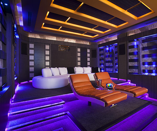

Another option could be front row seating as low fixed recliner style seating with minimal riser height. Coupled with an AT screen it might be a natural for low ceiling'ed rooms.

Posted: Sat May 21, 2011 4:37 pm    Post subject:
showed that picture to my wife - funnily enough she did not run screaming. said she liked the loungey recliners and that it needed martinis.
Posted: Sat May 21, 2011 4:56 pm    Post subject:
The lounges could also be very low, almost on the floor, so you wouldn't even need a riser for the second row...

Posted: Mon May 23, 2011 2:57 pm    Post subject:
Martinis indeed. Smile
Not my style but that doesn't mean there's not ideas that can't be gleamed from a design.
A Google Images search on "lounger" turns up many other designs ranging from modern to old world.
