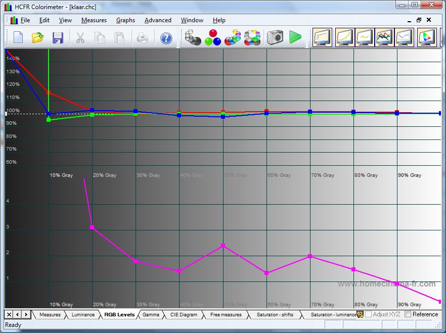

To get this topic back on topic: by cranking my contrast up to 90 I managed to get 10 ftL out of my projector. The grayscale is almost flat and the scan lines remain visible.
I think I can go and watch a movie now!

hi
@Gerbrand
how large is your screen?
my 1292 on an 100" screen makes calibrated 11ftl Gain is 0,9
regards
1292 without streaking

I have a 100" screen also.
