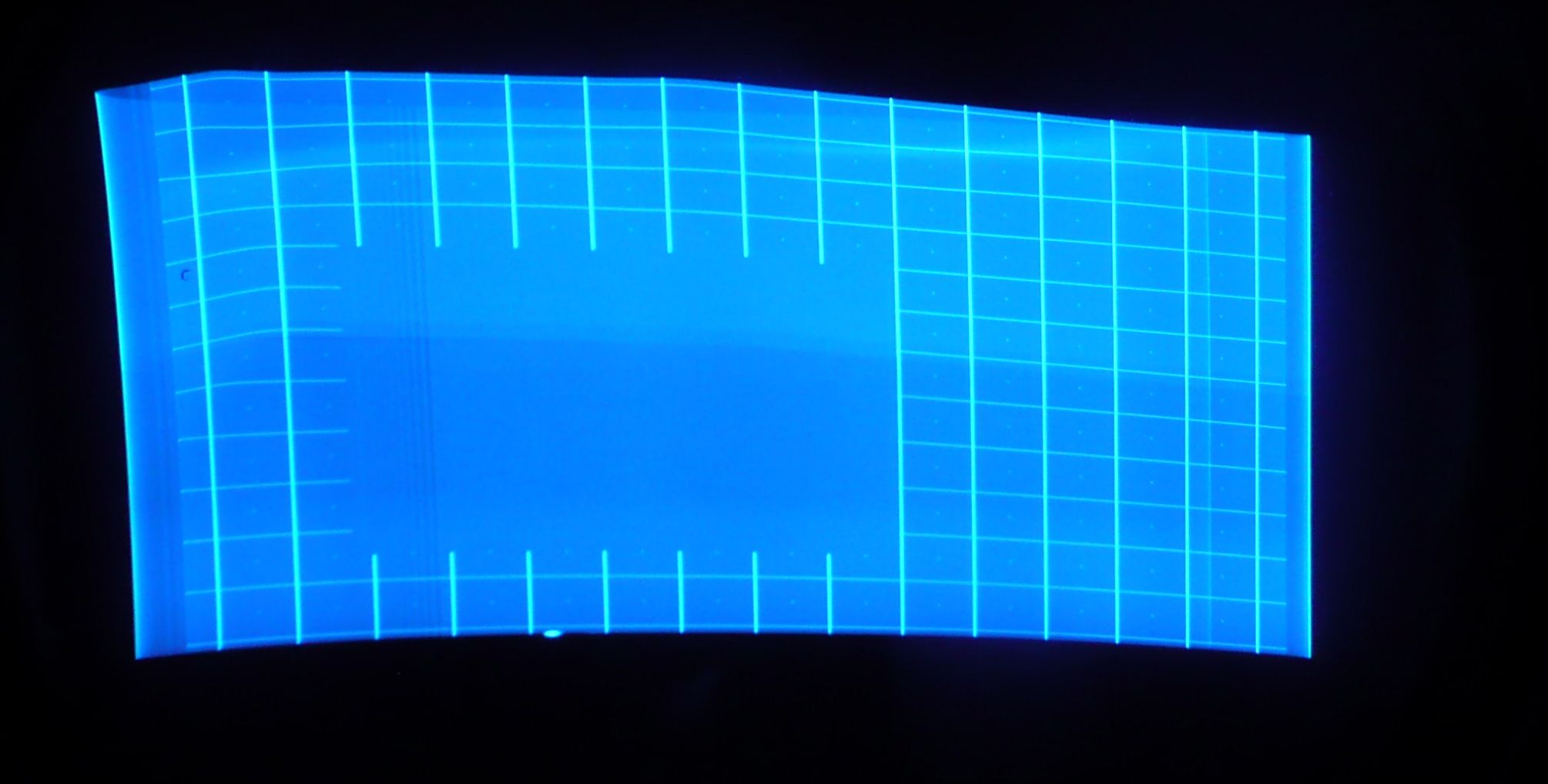

As promised a picture and small clip about the blue convergence problem
In the clip you see the shape of the grid changing while i change contrast or brightness.
have fun!
regards,
Ron.

Posted: Wed Jan 12, 2011 10:55 pm    Post subject:
Weird movie, is that happening when you adjust the contrast?
Did you initialize the set from the service menu to clear all settings?
Also did you clean the Chips on the HDM daughter board and the DPB on the CLM?

Hello Athanasios,
Yes this is happening when i change the contrast and I did a reset from current setting from the source setup menu but not from the service menu.
All the keystone correction dissappeared when I did this reset and the other two tubes give a perfect rectangle on the tube.
I didn't clean any chips only connectors.
I'll give that a try tomorrow.
By the way it's a very nice machine.
I've worked on TV sets but never on a crt projector
regards,
Ron
Posted: Wed Jan 12, 2011 11:25 pm    Post subject:
Ok the initialization May fix the issue. make sure when you get in the menu you do a complete initialization, this will clear up any
Corrupt memory.
Posted: Thu Jan 13, 2011 12:59 am    Post subject:
Hello
Unplug the blue convergence yoke to see if that is the origin of the distortion. I have never seen this problem before.

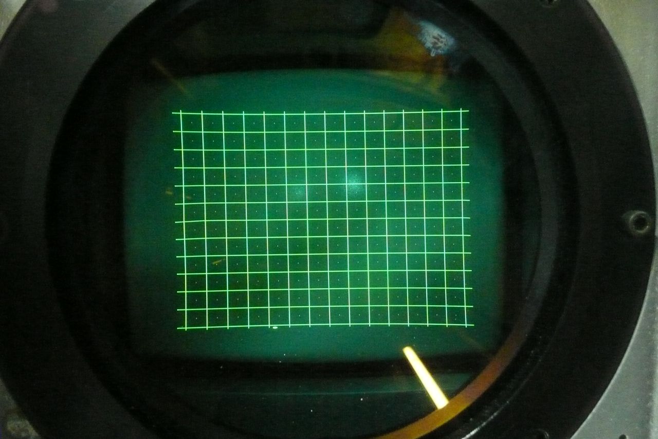

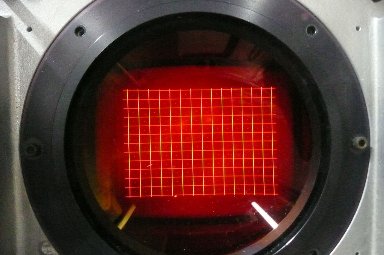

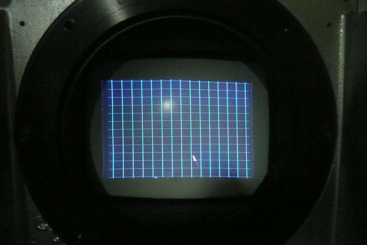

I cleaned all the daugther boards on the CLM and did a complete reinitialisation (that didn't solve the problem) and now all three pictures are nice but blue is still a little bit distorted (see the picture)
I noticed before cleaning the CLM that in the service menu the sigmator was not installed. After the cleaning however I was able to adjust the stigmator.
The cleaning did the job. I checked the hours and it was around 1000 hours with crt's on and 17 hours on standby. I Don't know if I can believe this but I think it has been retubed once because I have two tube modules that have a small sticker that says green to my knowledge there only on green tube in the projector Smile
I went through a rough (guided) convergence setup and there I noticed that the convergence adjustments for blue only work in the center but every other zone around it doesn't move when I press the buttons.
i think this is the last problem that's left before everything works. i guess some more cleaning is needed
I have also added a picture of the raster size on every tube after the total reset and i have the opinion that the image could be bigger. How far should i stay away from the sides a few mm?
This is important for me because i'm in the proces of building my home theatre and I would like to position my screen exacly so that I use the maximum phosfor area. As soon as I have that distance then I store the projector and finish the theater before really install it.
Thanks again for all your help.
regards,
Ron

Posted: Fri Jan 14, 2011 12:32 am    Post subject:
Hi Ron, every think looks good. Blue G2 needs to be turned down a bit so the raster is not showing. Also not sure but the red horizontal lines in the grid look a out of focus it could be the camera.
To do a proper set up use the Onscreen set up mechanical guide. this will adjust grid size etc. id go about 5 mm away from tube edge with all corners.
press help button to find the OnScreen set up guide.
Now for the convergence. double check the HDM cable connections, clean them well.
Aslo you can swap the CVA connectors to check the blue convergence, put the red on blue and blue on red.
go into random convergence and see if blue convergence moves the red grids. Press the color button to get to the right color because the program will adjust blue when you really want to adjust red. that is adjusting red will adjust blue. you will have to
flip back on forth through the two colors to look for the change. so do an extreame move for red and then go look at blue to see if that zone moved.
