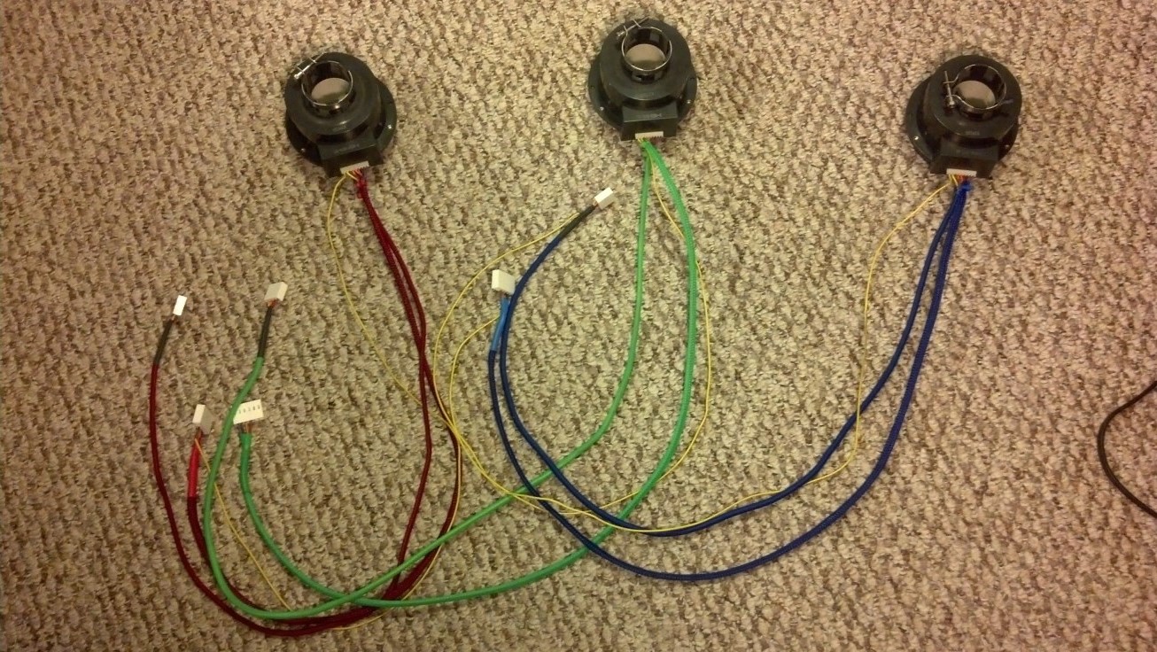

Posted: Sun Aug 25, 2013 7:17 pm    Post subject: Molex connectors
I recently acquired a set of Frankenyokes and was interested in putting Molex connectors on them without sacrificing my original Thompsons. I figure if I run into trouble or they don't work right I can put the originals back in my 9500. This also allows me to hopefully minimize the time my projector is out of service by having the new yokes ready to go. I was able to find the correct parts after doing some searching and wanted to post the links here in case anyone else would this useful.
Here are the 4 and 6 pin housings
http://www.mouser.com/Search/ProductDetail.aspx?R=09-50-8040virtualkey53810000virtualkey538-09-50-8040
http://www.mouser.com/Search/ProductDetail.aspx?R=09-50-8060virtualkey53810000virtualkey538-09-50-8060
Here are the crimp pins that go in the housings, I would buy a few extra
http://www.mouser.com/Search/ProductDetail.aspx?R=08-52-0125virtualkey53810000virtualkey538-08-52-0125
I've attached a picture of my yokes as well, I got fancy and put color coded wire braid over each harness. The other wires in my projector have these too. They look nice and keep wires from getting pinched Smile
