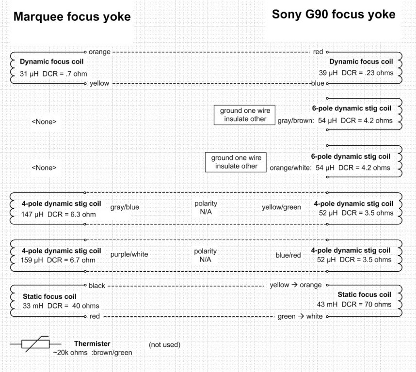

Guys, based on the discussion so far, I have updated my drawing. Please review and verify.
Thanks,
Steve

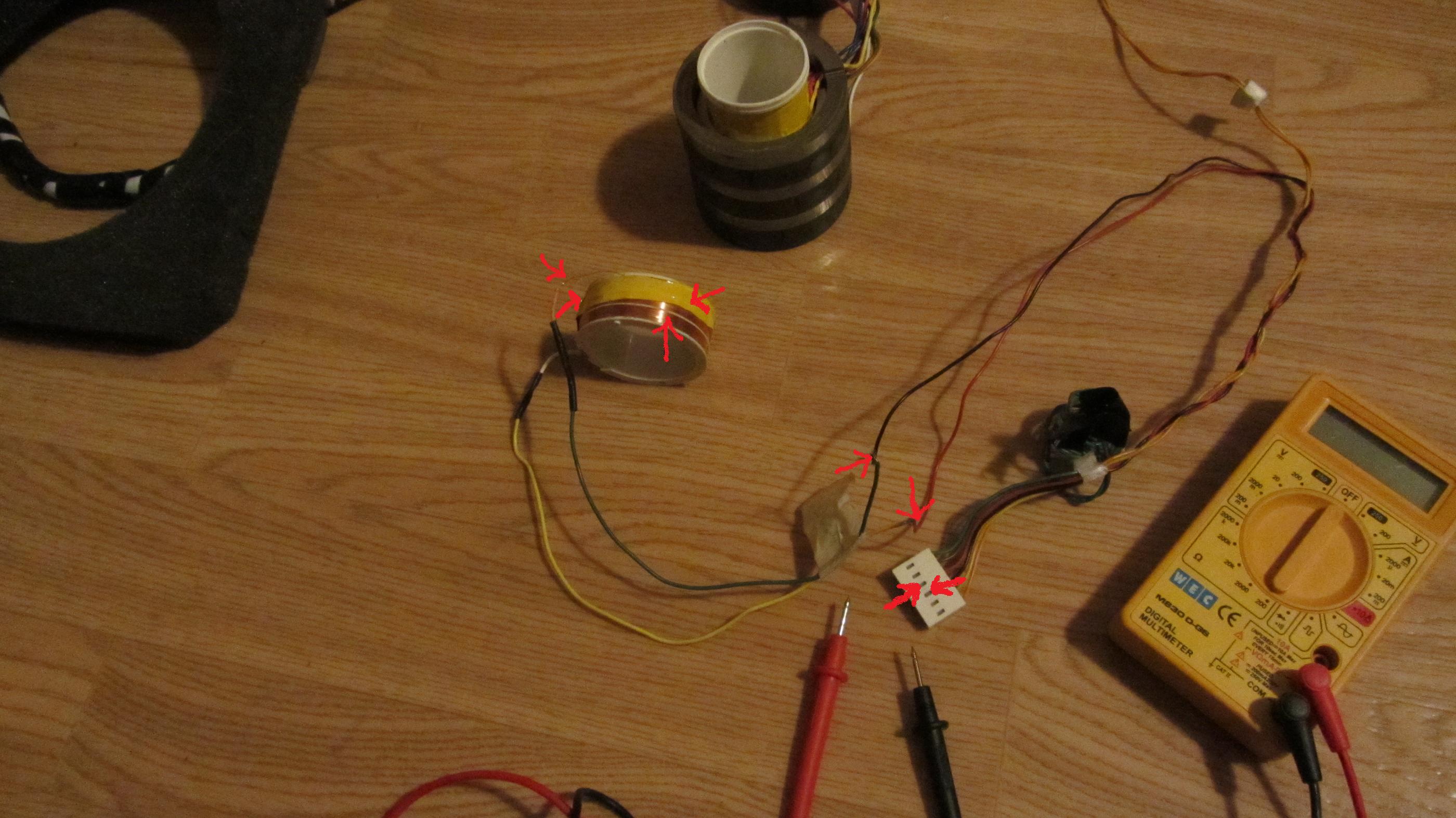

Ive tryed to messure all the red marks on the picture below. I get nothing and i can not see any damages on the copper wiring. If it has been broken deep beneth i have to rewind the whole coil to reach it. when doin messurment, does the coil have to be in its place(with the magnets over it).
possible options 1: put the old thomson yoke on the blue and see what hapens(even if it works i wont be able to run the contrast as high as i want). Do you think there is risk of damageing the PJ?
2: take the wiring from the tomson focus yoke and put it on the sony focus yoke, wild thought i know Embarassed it may not even fit in....
3:part out the projector Crying or Very sad

Posted: Sun Apr 08, 2012 7:41 pm    Post subject:
For now just use the old focus coil. it wont do anything bad. Also the Blue tube should be de focused for proper Greyscale anyhow.
You do know the wire in the focus coils is covered in Clear enamel. DID you make sure you cleaned it off before you connected the
harness wire?
andreas
Joined: 31 Mar 2010
Posts: 92
Posted: Sun Apr 08, 2012 8:25 pm    Post subject:
Athanasios! I did nor know that. I polished it with the easiest sand paper and... I got contact! i repeat, ive got contact hahaha
