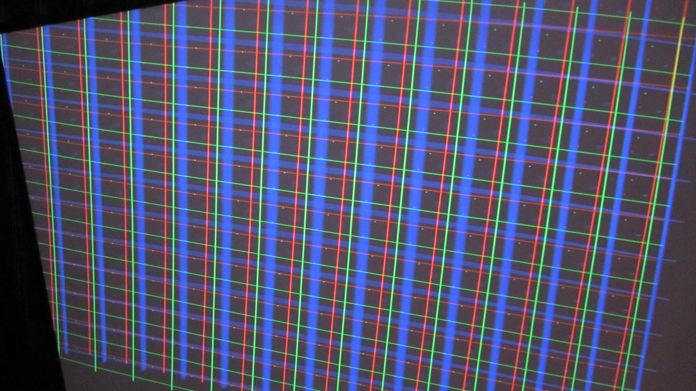

Hello! Ive turned the PJ on and it works, but it does not work that good yet.... one thing is that the picture is leaning. The other and probably more dificult to fix is that the focus is not that good, specially not in the center. The good thing is that i can adjust astig all over the zones as original on the marquee! I figure that the astig conection is the corect then.
if i turn the overall focus up 100 it is defocusing but when ramping under 50 nothing more hapens, its like its out of range for where it would be sharpest. Do you think it has to do with the conections ive made? AND corner focus does not seem to do much. the center focus afects the cornes greatly and the corners are actually the shapest. When doing the rgb focus the range rans out when going down to about 20(same for all colors). now its time to sleep
thanks again for all help ive got from you all!

The picture is rotated or " leaning" because the magnets might be in a different polarity compared to the Marquee's. this is why you might have to flip the coils the long way in the plastic housing. is it like this for all three? A fix is to un glue the deflection coil and twist the image back. Be careful there is high voltage on the deflection coils, DO NOT touch the bare wire ends!!!!
For the focus try reversing the static coils connection. Also disconnect all focus connections and see how the center focus is with no connection. It should still focus ok, if not then the magnet structure is weaker than needed, usually the winding will make up the difference if the Inductance of the coil is where it should be.

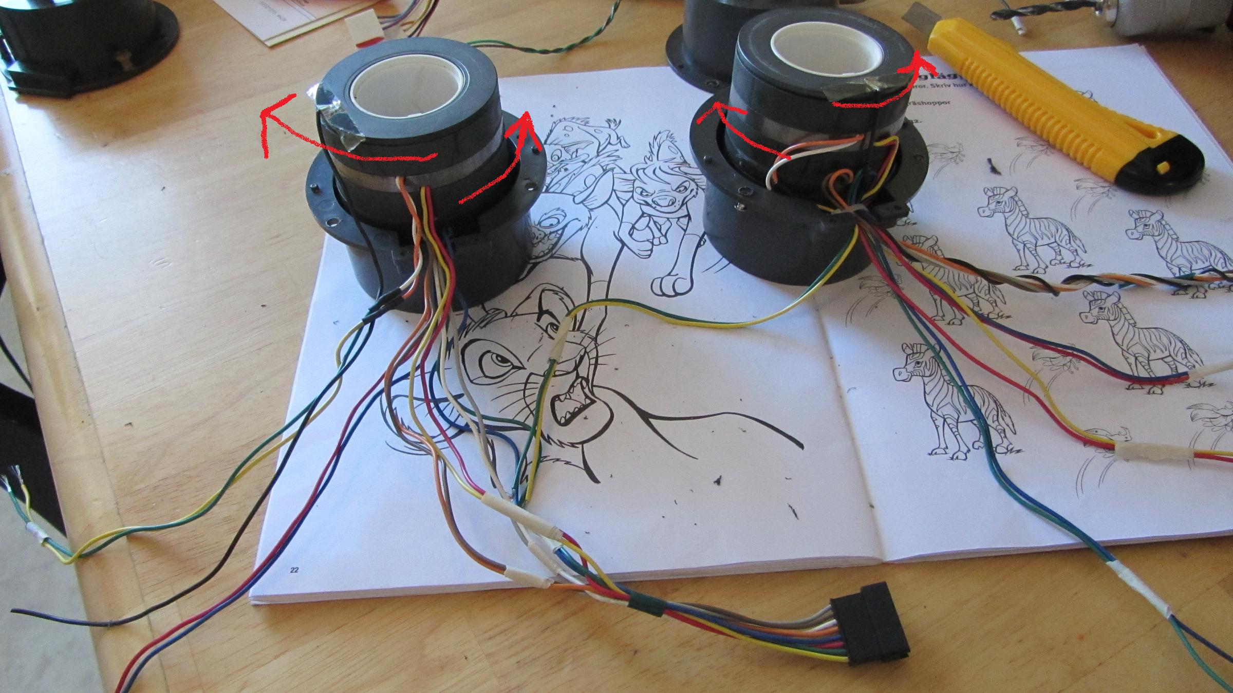

the focusi okey on the green+red but really bad on the blue, i have conected the cables the same way. is it about the rotation of the coils then? the rotation on the blue seems to effect the green and reds best focus point to.
 Filename:  IMG_0265.JPG
 Filesize:  395.09 KB
 Downloaded:  472 Time(s)
Posted: Fri Apr 06, 2012 3:55 pm    Post subject:
Rotation should not matter with focus but it might alter the angle of the image or the leaning you see, but I could be wrong. If you plan on removing the plastic housing and just using the magnet structure wrapped in Rubber Tape be careful not to touch them while powered on, the static shock is painful and scare the crap out of ya!!! I would add a ground strap taped to the magnets and then grounded to the Chassis somewhere. But if you can turn the coil while the PJ is on with no cables connected and see where the center focuses best and then lock the coil in place there. connect the cables and go from there.

hello! i must have been close to a shock like that then Shocked
this is what my testpattern is like. I can ramp the focus from 50 and upwards and from 20 in rgb focus mode. the pattern gets even more vlurry(unfocused) on the blue. the range are not enough.. it looked like that on R, G before i changed the dynamic focus wiring and was fixed by that. I conected the same way for blue but it turns out like this.... this yoke was the one of the three i bought that had been opened up. it looks the same as far as i can see.

ive messured the ohms and found out that the values seems to be the right ones for the static focus coils on the R and G, at the blue to at first but then ive got nothing. I think that perhaps the thin white and yellow wires has been damaged. Or worse that the coil is broken in some way. ive opened it up and tried to messure but got no results. Is it possible to use the marquee original yoke for blue and the new ones for R+G?
That makes sense. Maybe you can find where the conductor is broken on that static coil and dewind it a few turns (which shouldn't hurt anything) and restore that wiring connection.

andreas wrote:
hello steve and everyone interested in the subject. The static focus coil conection is:
marquee red-g-90 green
black-yellow
I did try to rewind but that was hard to du withaut rewinding the whole coil up. still no results... frustrating stuff. perhaps i can get help in some electronic shop or by a friend that know electricity. Or use the old thomson yoke but i think ive read it was a bad thing to do.
Very cool, thanks!
That's sucks about that open circuit static focus coil on that one yoke. the magnets in the yoke are glued to the steel rings and can be separated, but it's very tricky. You could tape the yoke first and then use a rubber mallet to try and break apart the yoke (that's what I did). It's not easy, and I'm sorry you may have to do this if you want to use that last G90 yoke.
