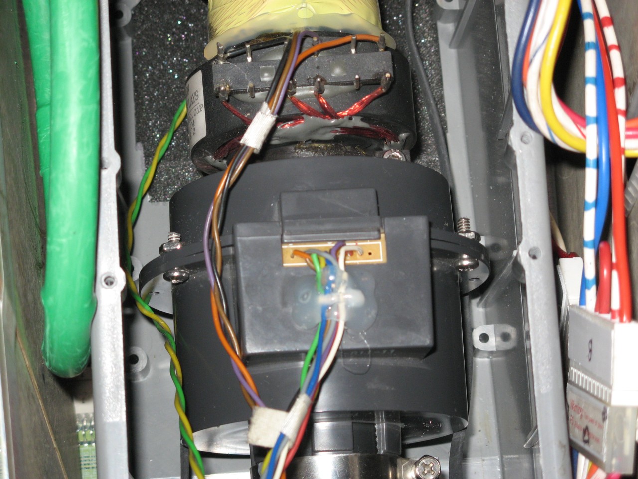

I tried a Focus coil in my 9500 yesterday on the green crt. I used the original casing and I flipped the coil 180 degrees so that it had the same Magnetic polarity as the original Marquee coil. So far everything looks good. I didn't have to rotate the deflection coil at all . Included below is a picture with the coil in place. I will be trying the coils on the rest of the crts this week if I can find the time. I'll get back with some more pictures when I have that done.

Be sure that the screws and nuts you're using to hold the two halves of the housing together are NON-MAGNETIC. Stainless steel or brass.
I recommend that you transfer the coils into Marquee yoke housings as it allows you
to position the focus coils closer to the bell of the tube. This will have an effect on
the focusing ability and range. Alternatively, modding the focus housing to the
same end may be advisable.
It's not as easy to come up with a good solution for recasing the Mark II coils as it
is for the Mark 1 coils, but a satisfactory solution is possible.

The screws I am using in the picture are stainless steel , I also have some nylon that I could use. I'll try using the Thomson housing and see if it makes a difference. Here is the patent link for the focus coil if anyone is interested

I just had a look at the convergence coil and the focus coil .If you remove the clamp that holds the covergence coil there is a plastic sleeve.The 22-22 focus housing would either fit over the plastic sleeve on the convergence coil or I could remove the plastic sleeve. That would move the focus coil at least 1/4" closer to the bell of the tube. The convergence coil is held in place with glue so it does not look like there would be a problem loosing the clamp.
