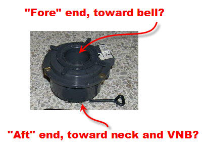

I finished wiring up the FYokeI's and went to put them on the 8500, when I suddenly realized I wasn't quite sure which was fore and aft. Smile I assume the "label" side faces aft, toward the VNB, and the side with the little compression neck and the long screw-hose-clamp-thingie (technical term Laughing) faces toward the bell? And presumably the hose-clamp-thingie on the 4-6-pole CPC rings faces toward the VNB?

Posted: Mon Nov 26, 2007 5:00 am    Post subject:
its hard to follow your description.
The rear end is the one that has the metal "hose clamp" that firmly clamps the yoke to the neck of the tube by clamping the plastic tabs the sit flush on the neck. you cannot go by labels because no two are the same. stickers can be put anyplace.
Did you turn the magnetics inside the shell?
AFAIK all sony yokes are 180deg out of phase magnetically with the thompsons. Its easy to check. just bring a thompson close and see if it respells or attracts.

My wife's got my camera so I can't take a picture. Here's a pic of a KF2211 I snitched from earlier in the thread. Do I have the front and back ends correct now? (I think I had it backwards before.)
Yes, I turned the magnetics in the shell. With the magnetics turned, the "label" end of the KF2211 (the non-hose-clamp end) repels the front end of the Thompson. So whatever repels the front of a Thompson should presumably be the front end of the KF2211, yes? And we want the hose-clamp to be on the aft end, so the front of the KF2211 can snug up as closely as possible to the coil in front of it?
Does fore & aft matter with the CPC rings? The I'm-guessing-4/6-pole rings have plastic tabs and a hose clamp too. The original 4-pole rings were mounted with their tabs & clamp facing the rear (neck/VNB) so I'm assuming the 4/6-pole rings do the same.
Thanks!

Posted: Wed Nov 28, 2007 1:19 am    Post subject:
The illustration in your previous post is correct. I think the idea being have the magnet as close to the phosphor as possible. Best position would be with static focus at 50, both picture menu and service menu, slide magnet back and forth on neck for best focus. You can leave the CPC magnets off until this is determined. If mag ends up against the yoke or 1/2" back then you are good to go. If it ends up back more than 1/2" then position it 1/2" back from yoke and see if static focus control will bring it in. If the mag has to be back more than 1/2" the CPC mags might be too far back on the tube to work. At any rate, the CPC mags should be up aginst the back of the focus mag. The magnet is the wrong gauss if it has to be too far back, same if it is all the way against the yoke and the static focus won't bring things into focus.

OK, thanks Chris. The max light output (contrast) is no different than it was before -- but now you can use it better because your focus stays good at those higher levels. But if you calibrated your projector to a max contrast level of e.g. 60, that includes defocusing the blue so it gives a good flat color temp across the IRE range. Obviously the blue is saturating at that contrast=60 level, otherwise you wouldn't have to defocus to keep the temps flat. So if we say for argument's sake that the blue starts to saturate at IRE100 & contrast=50, then you could run at contrast=50 with no blue defocus. But it's going to saturate at lower IREs at contrast=60, so you have to defocus -- but it saturates at even lower IREs at contrast=70 or 80. So wouldn't you have to defocus the blue even more to handle the saturation at lower IREs?
Thanks for the tips, Scott! So the CPC mags are supposed to be right up against the focus coil -- or at least as close as you can get them, since you do have the hose-clamp thing in the way.
