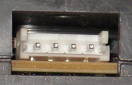

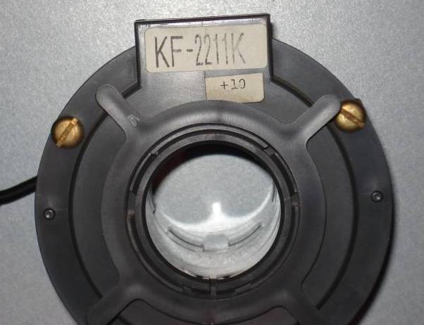

Here's what mine look like, with a close-up of the plug. I got mine from Clarence last year. He was housecleaning and didn't say where they came from.
CJ, are you saying don't bother with the plug, but just run the wires into the shell and solder directly onto the small board that the plug is mounted on?

Posted: Sun Sep 09, 2007 2:39 am    Post subject:
I'm saying that's how I did it. No need to try to find the mating connector or splice into a used harness, if you're willing to spend a little
extra time soldering wires in.
And also, my preference is to tuck the PC board into the side of the Thomson yoke shell. It's a tight enough fit without that connector in the way! It's definitely easy to tuck the board in with that connector removed.

Posted: Sun Sep 09, 2007 4:18 pm    Post subject:
Um, I'm confused. What PC board do you mean? I was talking about removing the molex connector and soldering directly to the mini-board that the connector was on. Which is already tucked in there (it's under the connector in the picture above) so I'm not sure what you're saying.
Looking at tekkentoh's post on the A site it looks simple to remove the connector and just solder into the mini-board that's already there. It looks like "red black yellow orange" (see the first pic in that post, or the pic in post #16) is the right order. I figured I'd just open up the KD shell, flip the coil, remove the connector, solder the wires into the mini-board, and put it all back together.

Posted: Sun Sep 09, 2007 6:19 pm    Post subject:
That's what I did FIRST. And with a 2211, for a Mark I FrankenYoke, you DO retain the ability to shift the yoke for centering, just like
with a Thomson yoke, if you transfer it into the Thomson shell. So I maintain that it's a worthwhile transfer if you don't have electronic
astig to play with.
As the Mark II is based on a focus coil that has a much smaller internal diameter, thereby eliminating the possibility of using the Thomson
style yoke centering feature, there's no need to transfer THAT coil into a Thomson shell.
And yes, the PC board I was referring to is the tiny one housed inside the KD2211/KD22-22 series focus yoke assemblies. There is no
other that I am referring to in the context of focus yokes and coils. I remove the white bodied connector from that board and directly
solder the yoke harness wires to the board. That way I don't have to even worry about trying to find those connectors or deal with
crimping those little pins without the right tool on hand.

Posted: Sun Sep 09, 2007 7:28 pm    Post subject:
CJ's right, Barry. I just checked the 22-11 bobbin on my 8500's tubes. It's significantly larger. It looks to me like it's the same inside diameter as the Thompson coil. The 22-11 **shell** fits snugly onto the tube neck, but that's because the shell has a sleeve that runs inside the bobbin.
From what tse says, you can center with the 22-11 by rotating it, but I doubt that's as flexible and powerful as the Thompson method. I guess there's no advantage to using the 22-11 shell instead of the Thompson shell? And if you use the Thompson shell you get the full advantage of the centering mechanism.
So I guess I *will* be moving the coils to the Thompson shells. I understand now what you mean about tucking the board into the Thompson shell, CJ. If I ever manage to find a set of 22-22 coils (not bloody likely considering how scarce and popular they are), I'll keep those in their original shells.
