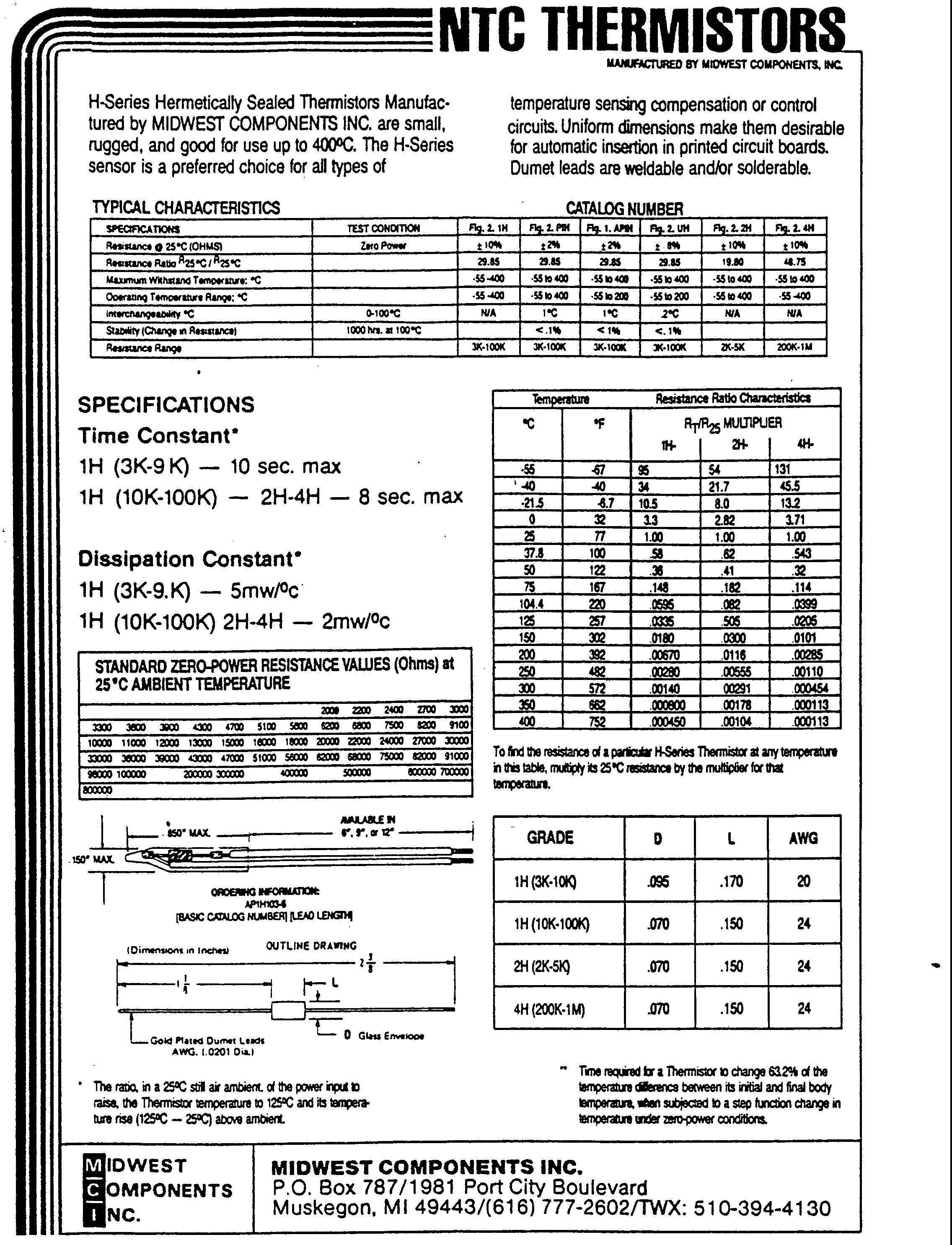

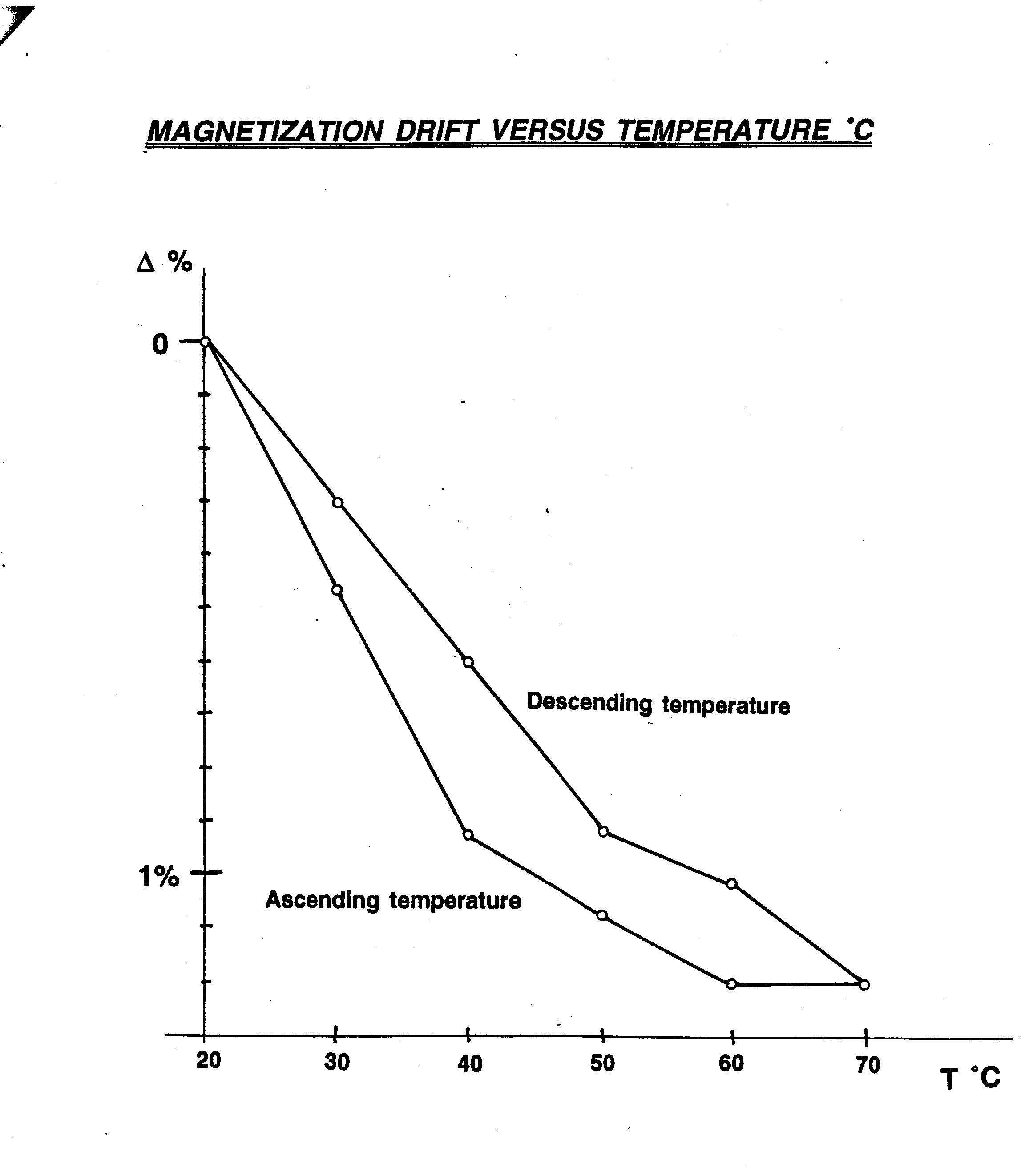

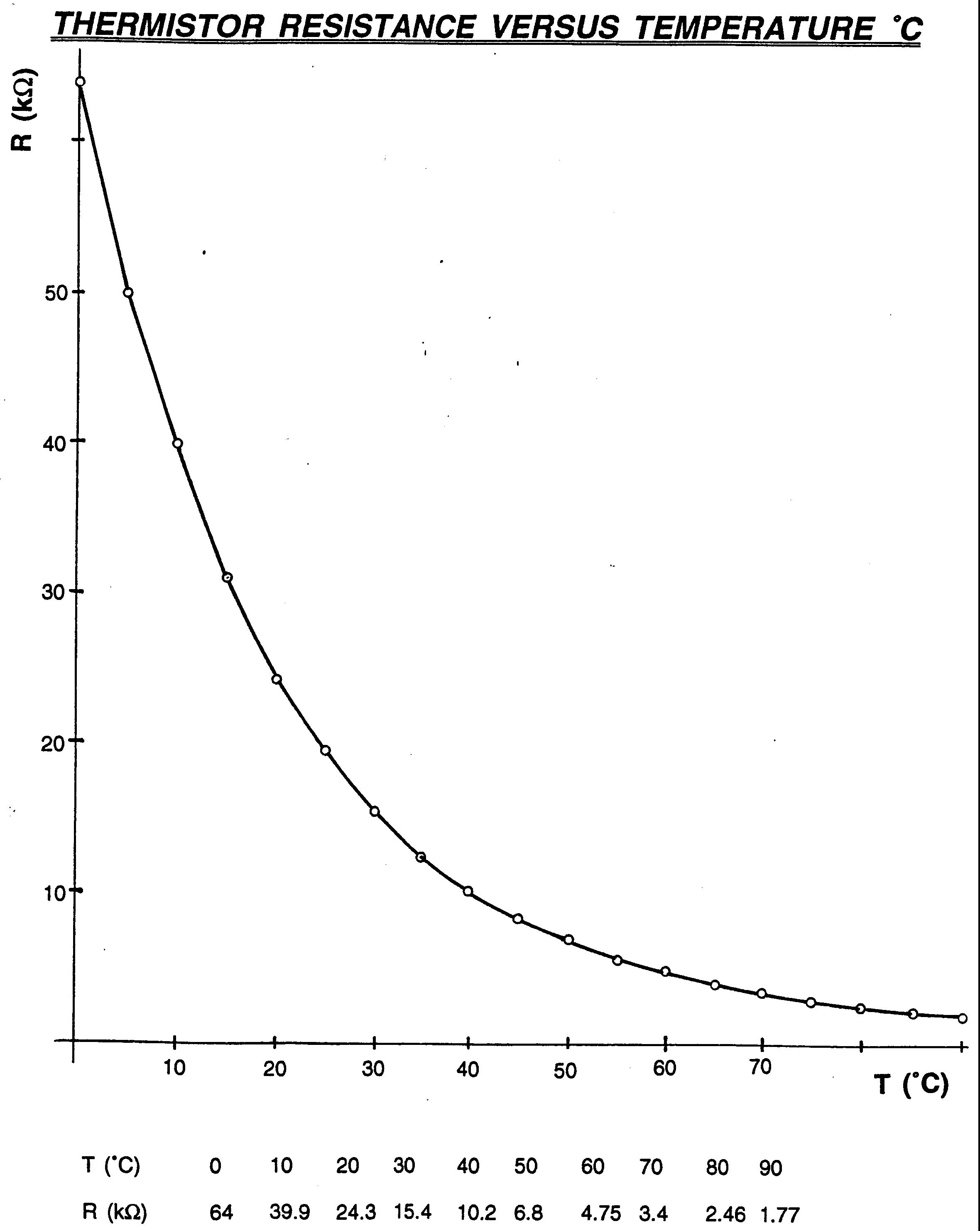

Joust wrote:
Got 'em running 8)
Made a drawing of the harness required. I'll post it latter.
in short it was an improvement. Dot shape is better and raster centering is better.
didn't have to mode deflection coils at all.
Going to have to look into the temperature compensation of the thompsons so we can add that.
resistance measurement shows 20k. probably just a NPT resistor.
Better late than never. Attached is some information on the Thompson focus mags and the temp co thermistor.
Scott
