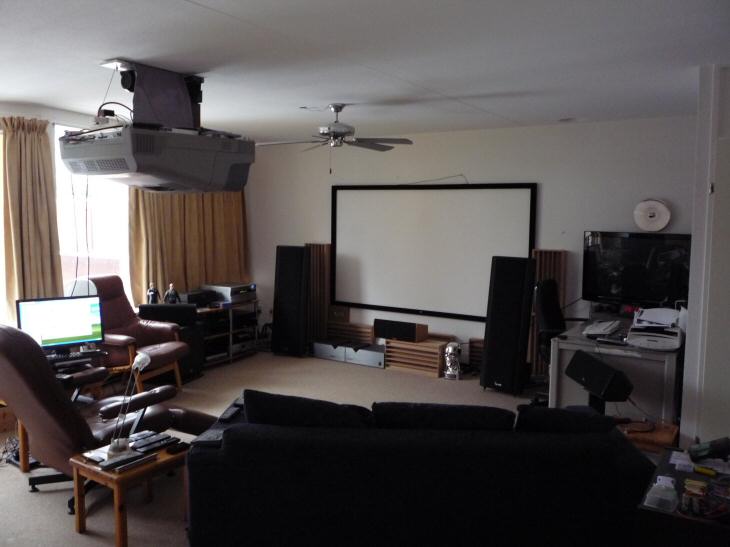

1292 up and running!
 Filesize:  43.1 KB
 Viewed:  20710 Time(s)
