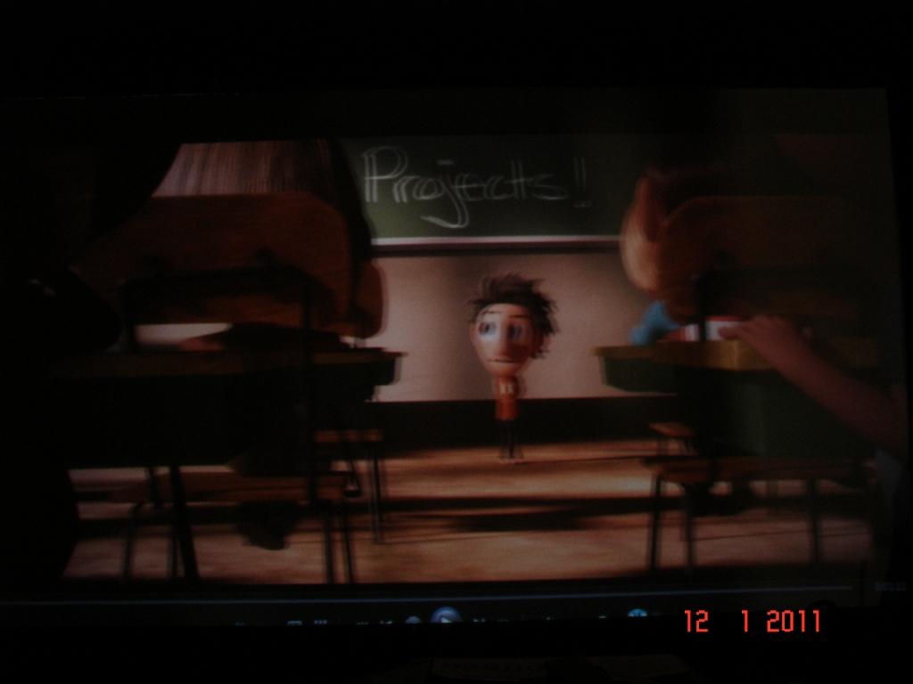

Posted: Wed Jan 12, 2011 12:09 pm    Post subject:
Here is a first screenshot of my 3d-bluray playback result:
Cloudy with a chance of Meatballs, 3D-720p@120Hz, SONY 1292
