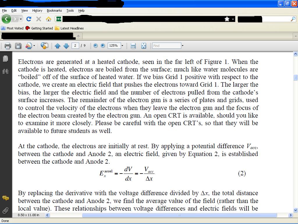

Posted: Wed Jan 12, 2011 5:12 pm    Post subject:
Another interesting document. The first 3 sentences pretty much only apply.
