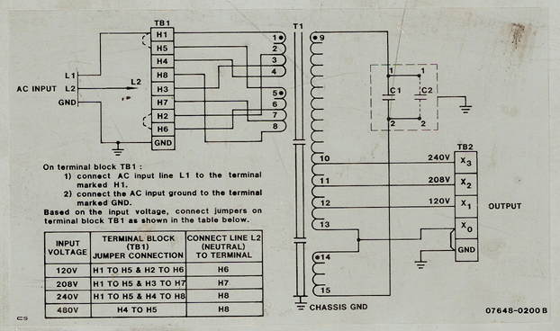

Approximate load is 1180 plus a few wall warts for the cable box, DVR, Extron, and HD Fury.
I checked the wiring since I wasn't involved in wiring it up. It is correctly wired on the H and X sides but something seems strange to me with the grounds. I could be wrong though.
Topaz Escort 68200-08
Ground comes in and lands on the H Ground terminal. H Ground terminal is hooked up with a jumper(factory) to X Ground Terminal. X Ground Terminal is then sending ground to my outlets. Also, X Ground is jumped (factory) to X0 (neutral).

Posted: Sun Nov 07, 2010 6:57 pm    Post subject:
With my set up I can touch the ground and hot wire and not get shocked. I think yours is connected wrong in that respect.

Posted: Sun Nov 07, 2010 7:16 pm    Post subject:
Ok. I put the meter on this thing and I do get voltage when I connect hot and ground. 120VAC. This would be correct considering that the neutral output is jumped to ground on the X side as shown in the print.

"Approximate load is 1180 plus a few wall warts for the cable box, DVR, Extron, and HD Fury. "
Is that 1180W or 1180VA?
If it's W then you could be pulling 2400VA from it which would explain both the noise and heat.
You have to factor in "power factor" when sizing equipment.
The slightest DC present will also saturate the core and make it run hotter.
So measure that as well.

Posted: Sun Nov 07, 2010 8:53 pm    Post subject:
#1 - You're connected load is probably too large, which would explain both heat and noise. The noise is coming from the laminations which are acting like a loudspeaker.
#2 - You need to disconnect the bond between ground and neutral on the secondary side. With this bond, it is no longer isolated, and you are getting almost no benefit from the transformer.
Since you already own it, I would selectively remove the large loads and use normal power for them. Most likely your large loads are power amplifiers.
I would use the x-former only for your projector, and all the small signal devices such as disc players, preamps, processors, satellite receivers, stb's, etc. These devices are also more prone to problems with ground loops.
But, absolutely remove the ground bond on the secondary!
Bob

Posted: Mon Nov 08, 2010 12:20 pm    Post subject:
1180 watts.
Removed the jumper and turned it on wit. With all loads removed. It's still humming away. I'm not shure what to do at this point but remove it from the circuit.

Posted: Mon Nov 08, 2010 11:58 pm    Post subject:
I ran it for an hour with no load. It got slightly warm so there's a huge improvement there but I never did any testing immediately after removing the jumper on the secondary from the neutral to ground. Regardless the hum is still there despite tightening up the chassis. Slight improvement but most definitely unacceptable.
At this point in time I'm going to bypass the transformer and return to the original wiring setup until later. I have a Marquee issue that needs to be addressed in a new thread.
