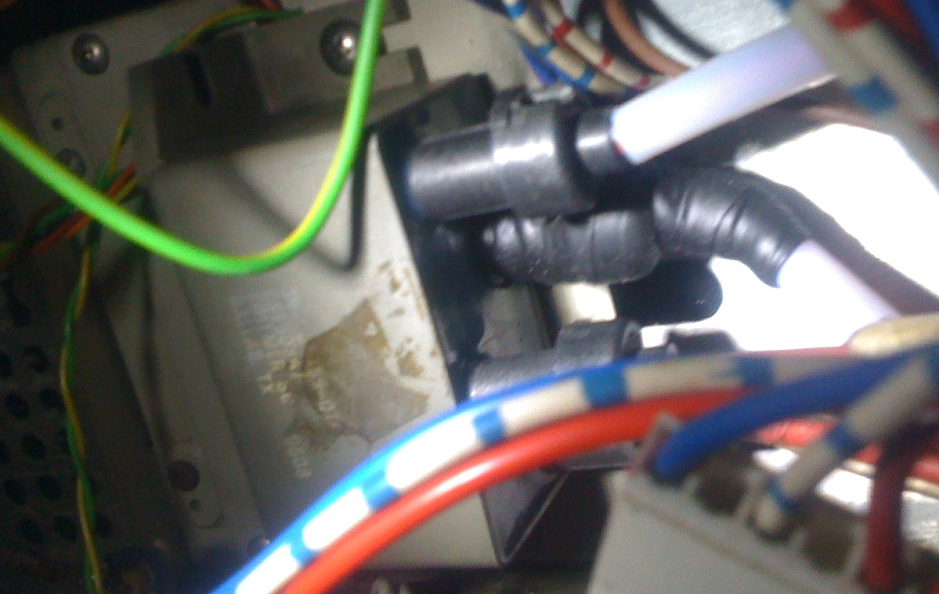

I was doing some testing on the projector and when the movie scene was dark, I found out that the sparking noise actually came from the high voltage cable from the green tube that connect directly to the HV splitter.
During total darkness, I can see sparkling lights emmiting from the cable that caused arching.
There was evident that previous repair technician was trying to use black tape to wrap around at the cable connection in order to prevent arching but was not successful. (Refer to photo attached)
Please help as to how I can prevent arching or spark from this cable.
During total darkness, I'm able to see spark / arching coming from the green tube high voltage cable connection with black taping

Posted: Wed Oct 20, 2010 3:08 pm    Post subject:
are you sure the cables are secure in the splitter?
it takes some force sometimes to get them in right, you should here them snap into the splitter (not always).
what you could do is take the cable out discharge the copper end on the chassis 2 or 3 times and clean it with alcohol and put it back in firmly.

Posted: Wed Oct 20, 2010 4:05 pm    Post subject:
In that pic it looks like the HV cable is bent and probably not secured properly to its connector or the connector is broken.
I would remove the tape and look at the HV splitter to make sure its not damaged. you could also leave the Green HV cable out and fire up the PJ to look for any HV leaks out of the spliter casing.
Curt has new HV cables if yours is damaged.

Posted: Wed Oct 20, 2010 4:50 pm    Post subject:
Thanks for the feedback. I've removed the tape and did not find any damaged to the splitter or the cable connection.
Somehow after cleaning and securing them in place, I could still see spark (dim light) at the exact location but the noise was not that evident anymore
As advise by Athanasios, the spark & noise was totally gone when I disconnect the green HV cable out and the projector seems perfect for the very first time using blue & red tube.
Please advise as I have actually replace the HV splitter with a spare unit but the problem is still there.

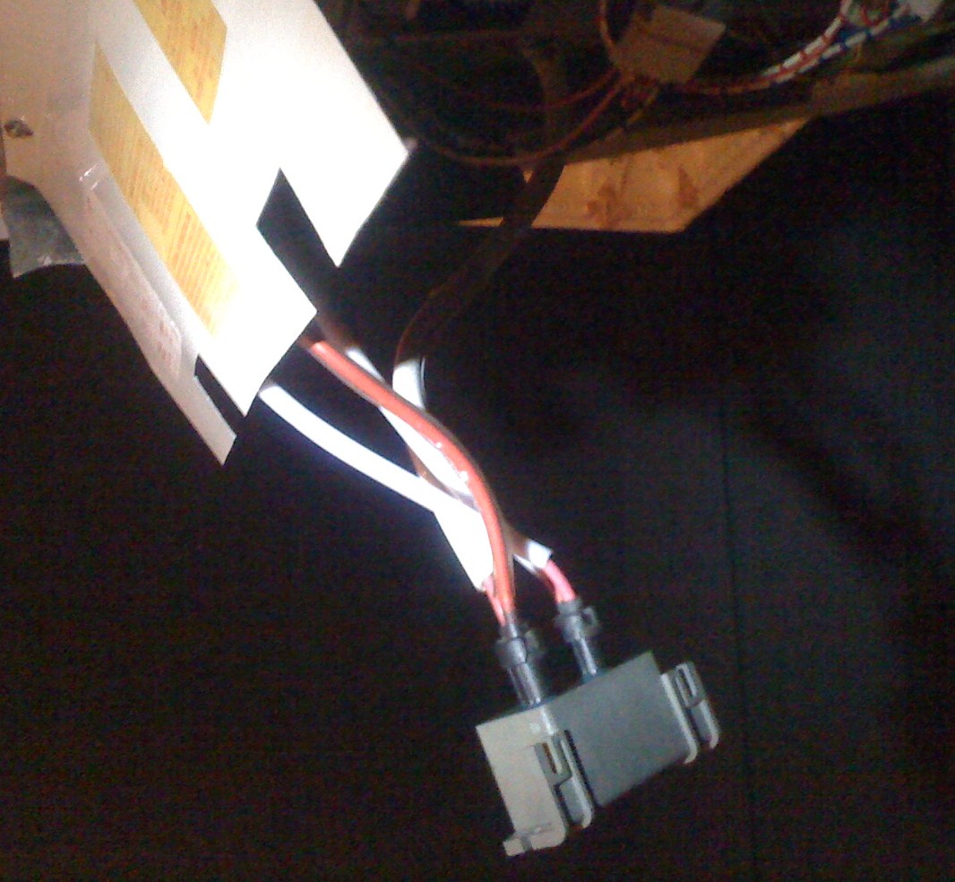

I've clean the cable as instructed and detach the HV splitter and everything seems alright for about 3 hours of running. (Refer first photo)
After I'm convinced that the cables is OK, I've decided to re-install the HV splitter at the original location and start the machine again. My hapiness shortlive as there was a fire coming out from the same cable again and I immediately 'OFF' the machine to prevent further damaged. Refer to 2nd & 3rd photo.
As I'm still not satisfied, I then detached the HV splitter again and place it at the same exact location as per 1st photo and it works perfectly again.
Please help as I'm at lost right now!

haireez
Joined: 14 Jun 2007
Posts: 207
Location: singapore
Posted: Thu Oct 21, 2010 4:06 pm    Post subject:

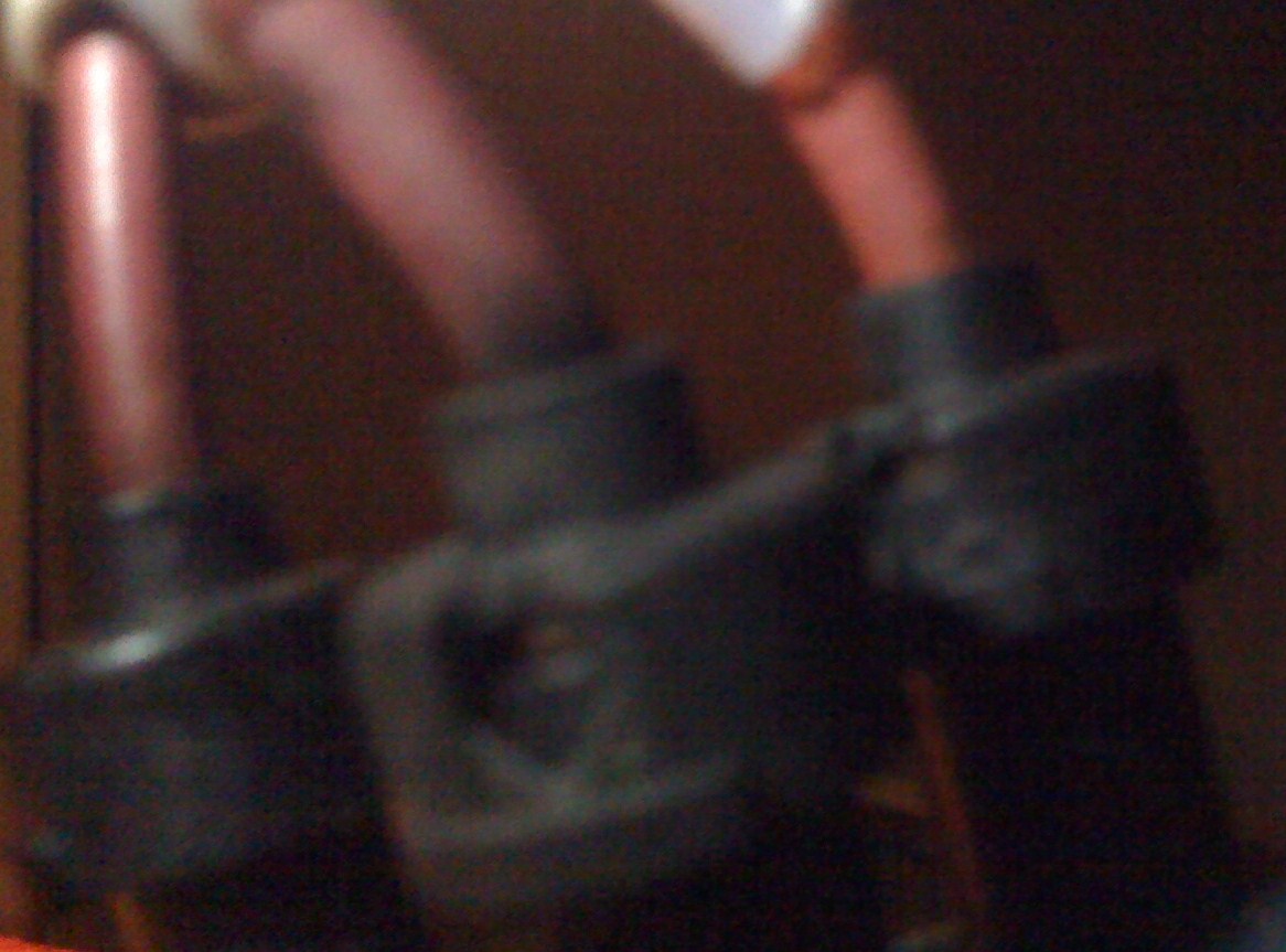

2nd Photo
Burnt evident on green tube metal casing
 Filesize:  153.27 KB
 Viewed:  3331 Time(s)
haireez
Joined: 14 Jun 2007
Posts: 207
Location: singapore
Posted: Thu Oct 21, 2010 4:08 pm    Post subject:
3rd Photo
3rd Photo: Burnt evident on green HV cable (Middle cable)
 Filesize:  155.41 KB
 Viewed:  3335 Time(s)
dvh99
Joined: 25 Dec 2009
Posts: 2158
Location: nederland
Posted: Thu Oct 21, 2010 7:42 pm    Post subject:
replace the cable like dragan said, before you damage other things inside the pj, do not run the pj anymore with the arcing.
curt sells the cables.
Posted: Thu Oct 21, 2010 7:54 pm    Post subject:
Your lucky no one walked by that hanging Splitter!!!! You Green HV cable is dead! A small pin hole will allow it to arc to anything that will conduct electricity, even a human!!! Replace the Green HV cable right away and do not use the PJ till you do.
