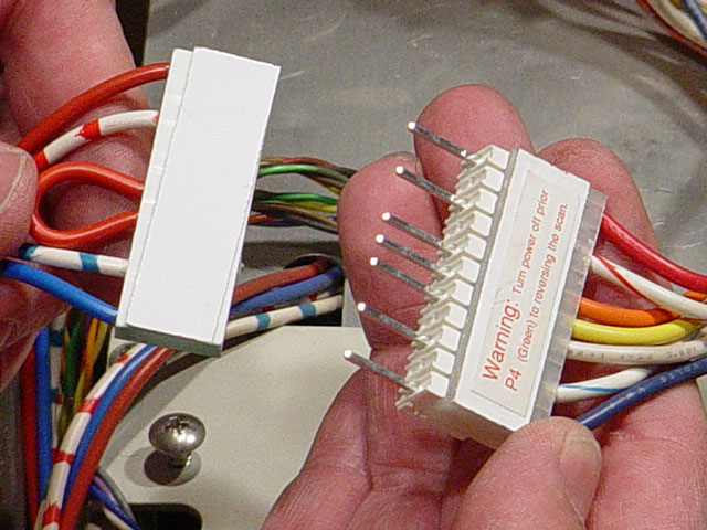

Posted: Tue Oct 12, 2010 10:53 pm    Post subject:
Hello
Unplug a horizontal scan yoke, this will disable high voltage. Restart the projector and listen for the noise.

Posted: Wed Oct 13, 2010 2:34 pm    Post subject:
Hi Tim,
You're absolutely right. After pulling out those plug, the high pitch noise was no more there. After I put back the connector, the sound start buzzing again.
Please advise as what need to be repair or change in order to solve this problem.
Thanks for the help.
2 White Vision 1

Posted: Wed Oct 13, 2010 3:05 pm    Post subject:
Haireez- pulling the yoke plug will disable the HV and the H yoke section. By the sound of Maniac's clip, you have one of the deflection yokes that is buzzing, so you'd need to change that. I have spare deflection yokes if you need them.

Do you mean Horizontal Scan Yoke?
that is what is in Tim's picture.
