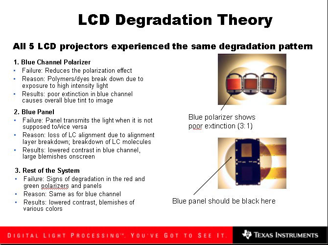

Posted: Wed Oct 06, 2010 4:41 pm    Post subject:
more
 Filesize:  75.35 KB
 Viewed:  22484 Time(s)

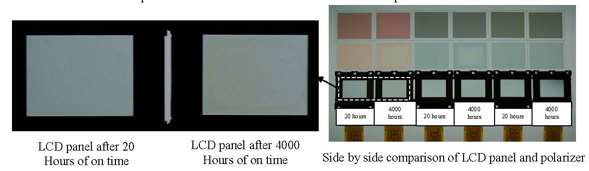

Posted: Wed Oct 06, 2010 4:50 pm    Post subject:
more
 Filesize:  43.03 KB
 Viewed:  18525 Time(s)
