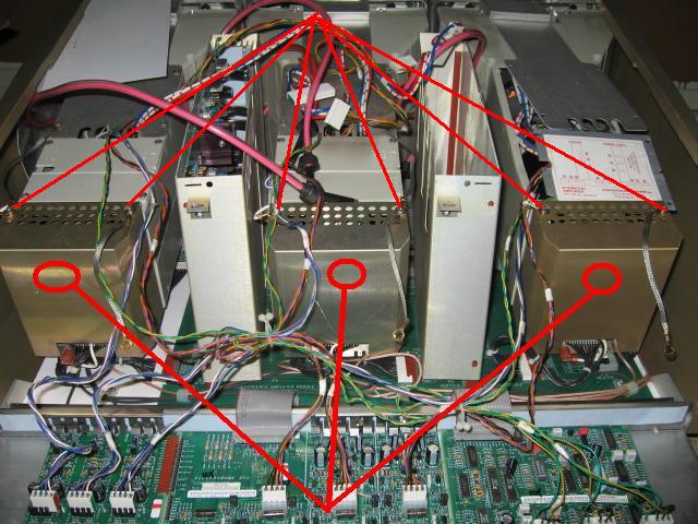

did you hookup all the ground straps, including the aquadags ( 2 long leads that are at that very top of your pic above)?

i always put the 2 aquaducts Smile on while holding the neck card in my hand because some pressure is required putting them on, same goes for the white ribbon cable below the rca connector and the rca connector.
when these are on i put the neck card on the tube and connect the remaining 2.

Yes, I connected all the ground straps and the two aquadags (the two cables with the blue plastic cover, right?).
I did the procedure without the back covers shown in this picture http://www.curtpalme.com/images/MarqueeTeardown_39.jpg so the blue ground strap path was not like neck board -> back cover -> big back heatsink but it was like neck board -> heatsink. It should be the same, but I'm not 100% sure.
