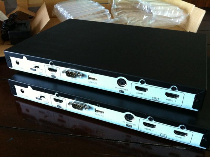

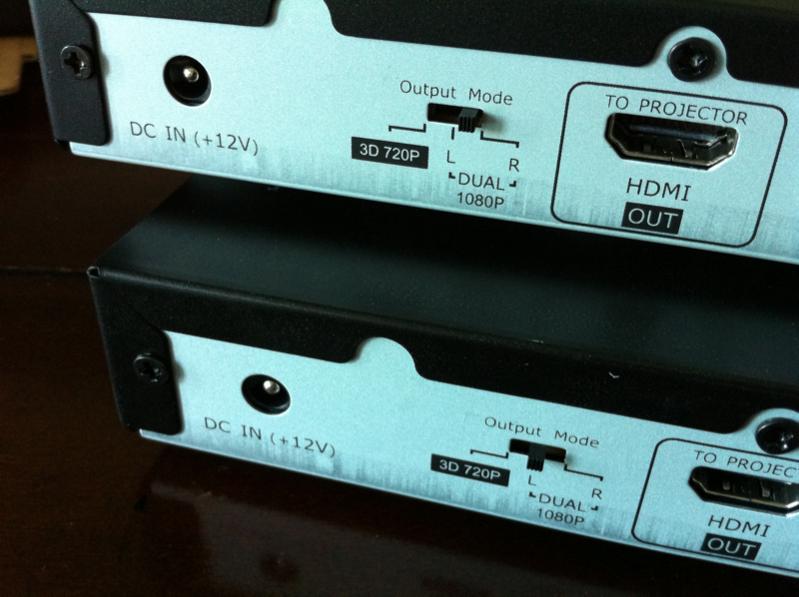

Apologies to Craig for being A little off topic..
To allow dual projector/stack 3D setups 2 of these cheap Optoma BG-3DXL work as A muxer when set 1 for Left 1 for right for Passive..
http://www.optomausa.com/store_productdetail.asp?product_subcategory=29&productcategory=3D Accessories
From my understanding they will work with HDMI 1.3 and pass any rez upto 1080p 60Hz per box..
Abviously still need these http://the3dmarket.myshopify.com/products/linear-polarized-filters..
Jase...

I don't think $800 for 2 of them is cheap, but it's a start.
Why would a hdmi demuxer output 120Hz?
The reason that I choose for such a box is that my crt's can do 1080p@60.
I suppose the 120Hz input results in 2x60Hz output because it alters the l + r frames.
