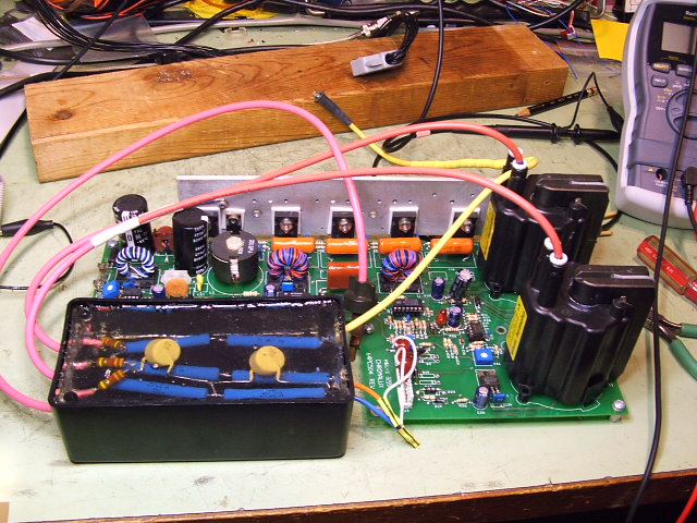

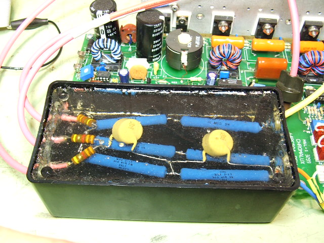

Posted: Mon Sep 27, 2010 3:11 am    Post subject:
You make the spacing right even fiberglass resin will work for potting material in a HV component. Check the attached pic. A HV supply can be made without a multiplier section. You can stack secondary windings (4 x 9kv) in the flyback transformer and directly output 35kV. The second pic shows this. Two transformers are needed as one is only capable of 2ma continuous.
Scott
 Filesize:  120.67 KB
 Viewed:  4472 Time(s)
 Filesize:  119.02 KB
 Viewed:  4476 Time(s)
