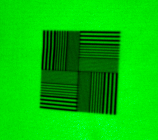

So, I figured the thing up tonight and spent a couple of hours messing around. I got RGBHV input working fine, though the menu system is... obscure, to say the least. In some ways Sony's menus are great, and in some ways they're a massive WTF (popping all channels back on when you go to adjust a different item, for example, or letting you adjust a channel that's muted. Christ, I remember that one biting me in the ass with the 1271...).
Stig on green is very good; red focus needs to be pulled pretty hard electronically and R and B stig might want correcting in hardware. Not sure yet.
My input was a too-long VGA cable rather than a real RGBHV cable, so I think it was pretty bad. Lots of ghosting, etc. And I wasn't able to get powerstrip doing custom resolutions on my hacker computer I'm running this with in my office.
So, first official screenshot of the G70, on a 60" wide "screen" consisting of somewhat rumply big paper on the wall:
1080i60. Scanliney as all hell; never had a similar look with the Barco even when it was almost as sharp. But this is *already* sharper than I got the Barco.
Damn. This ought to be fun. Thumbs Up
Oh, and electronic stig? My god! I mean, I love my Barco, don't get me wrong, but this is a freaking Jeep-to-Land Rover kinda move here. Yikes!

Oh, and the scheimpflug? I figured, "What the hell, I'll see how hard it is to do this", and after about three screw turns and a corner focus adjustment, the blue optical was better at the corners than I've gotten my Barco all these long years. I mean... you could see what happened! Turn knob, top defocuses and bottom focuses! Christ, it was like someone else was doing the work for me...
It reminds me of the story about a guy who's walking down the street hitting himself in the head with a hammer. Someone stops him and says, "Why are you doing that?", and the guy says, "Because it feels so good when I stop." Three years of hammering, and this is feeling pretty good!
Also, I'm suspecting that optical's going to be better when I'm running on my real screen and don't have the thing squashed down to its absolute minimum screen size. Hells yeah.
There is a lot to be said for a continuously adjustable scheimpflug with an infinite number of positions between max and min Smile The G90 is the same, just turn the wrench and watch the screen.
When you do the scheimpflug on your final screen, defocus the tube you are adjusting slightly with the center optical focus to make everything slightly fuzzy. It makes it much easier to see when you have the same exact amount of fuzzy on opposite sides than when you try to compare which is sharper Wink As you go along, tighten up the center focus and then defocus optically with the edge focus and repeat until the edge focus requires the same trim on the top, bottom, left, and right. You will get it supper tight.
I am spoiled and whenever I work on a projector that uses shims I am just like UGGGG now.

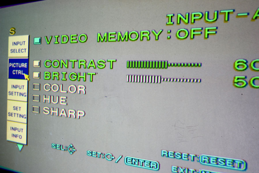

Posted: Fri Sep 17, 2010 2:00 am    Post subject:
OK, so, here's a shot of the assumedly-bad levels thing. Background is full white output; obviously the menus are quite a bit brighter.
Is this by design so you can see what's going on, or is something messed up?

Posted: Fri Sep 17, 2010 2:15 am    Post subject:
Hu, what are you talking about?
Where are the bias and gains set. Check them and post the numbers.
I don't think that the menus get dimmer if you turn down brightness, contrast, bias or gain on the G70. So your full white may not be max output of the tubes and menu.
It looks to me like the projector is work, no? Did you pull out the Moome?

Posted: Fri Sep 17, 2010 2:17 am    Post subject:
I'll check mine, but I think that's right, Perisoft... IIRC, the menus are independent of brightness/contrast settings. It makes sense if you think about it... Like you pointed out, otherwise you could inadvertently make the menus impossible to see.

Posted: Fri Sep 17, 2010 2:24 am    Post subject:
Contrast definitely affects menus.
I just tried going in and cranking gain/bias/contrast all the way up; if I do all of them then the outputs match the menus. Anything less and the menus are brighter; seems like the menus are brighter by some ratio until they start to saturate and the 'normal' output catches up.
So, it could be that a previous memory had much higher gain/bias, and it wasn't noticeable until I triggered another memory without such characteristics.
That still doesn't explain the slight jitteriness, or, more worryingly, the random times when green drops by 80% or so.
Right now I'm using direct VGA->RGBHV, but I've seen the same behavior with the HDF.
When the Moome was in there, the red was rock solid; no jitteriness at all. Looked great. Too bad it was only the red channel. Smile
