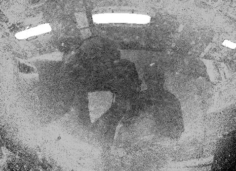

Oh, here's something funny. I figured I'd do an auto-levels check on the red lens to see if there's some hidden wear. There isn't. But I did find this...
I'm on the left, the guy I'm buying it from is standing behind me. There are fluorescent lights overhead.
Rotate 180 degrees, pull green channel, auto levels, cut the fluorescent lights out to avoid them screwing with the levels and auto levels again... Since there's a lot of 'hotspotting', I copied the layer and did a severe rotary blur around the center of the 'hotspot' (coldspot?). I duped it and mirrored the bottom to the top, because the top had holes. The blur gets rid of the high frequency information (the image reflection) but not the low frequency (the overall shading). I did it rotary because if you blur on all axes it'd affect the position of the hotspot.
So, then invert that, put it over the last step and fade until you get nice solid gray edge to edge. Copy that merged, auto levels THAT to spread it out, do some manual selecting of bright spots and hand-leveling, denoise, fill the 'bright lights' back in with white, and voila!
Anyway, so, yeah, I don't think there's any burn in there.
