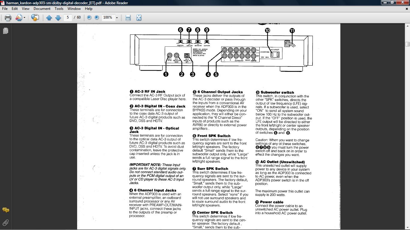

Thats what has me confused. It already has 6in/6out, processed or bypass.
 Filesize:  165.74 KB
 Viewed:  13000 Time(s)
greg_mitch
Posts: 5320
Posted: Wed Sep 01, 2010 3:11 am    Post subject:
Hmm...looking at that photo it appears he doesn't need to hack anything.
