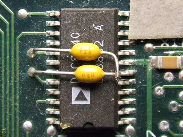

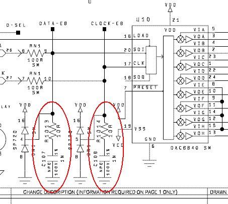

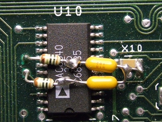

There is an IC on one of the boards (sorry, no schematics at home) that has two caps soldered to it. Little yellow guys. There is a change to that mod that puts a couple of resistors in series with the caps that helps to filter out some garbage on the serial bus that runs throughout the projector. The garbage on the bus causes stuff like what you descibe. Settings changing then snap back to the right setting with just a touch of the remote control buttons. I'll get more info tomorrow.

I think its U10 on the Vim right Scott?

The fluctuating brightness might be a VIM problem. The serial bus (dac bus) evidently has had problems from the beginning. Electrohome put 100pF or 330pF caps from the clock and data lines of U10 to ground. When VDC made the split pack (two box w/umbilical cable) units the bus started acting up again. Attaches are pics of the schematic (VDC) and mod on the PCB. A couple of 100pF caps will probably fix it. If not try the VDC mod of 10 ohm resistors in series with 1000pF caps.
