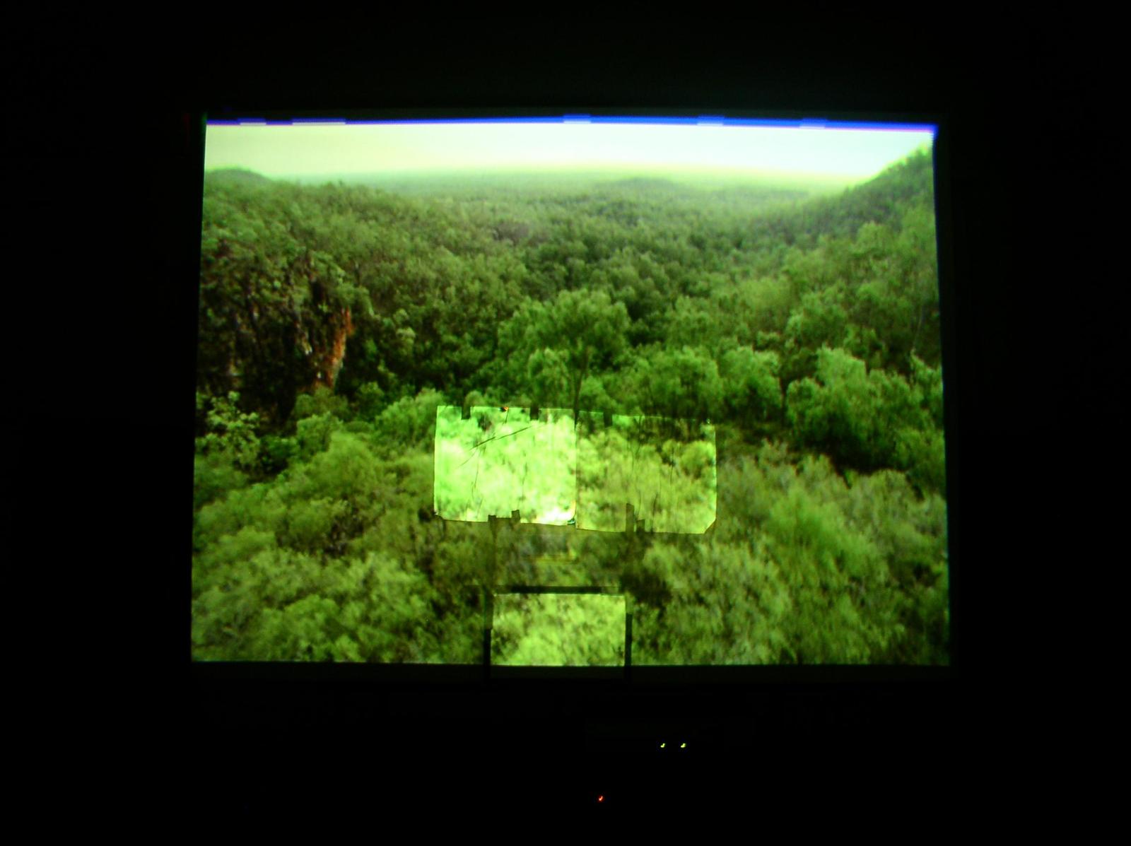

The UHG is what I talked to you and James about regarding the mylar. I have a translucent coating that I can put on it to get the high gain, but I haven't tried spraying a whole screen. It would be a challenge, but doable. I can sell you some of the coating if you want to try. It is about a $1 an ounce. You would probably need around a quart. You might be able to take the mylar to a body shop and have them spray it, but you would need a way to see if you have the right amount of coats on it. You can get the mylar here:
http://www.mirrorsheeting.com/
In all honesty, you would be better off trying to find a used Vutec UHG screen. They come up from time to time on ebay and elsewhere. The biggest problem is shipping, as it is a hard screen.
Here is a pic I took of my UHG experiments. Top left is no pigment coating over mylar. Top right is maybe white pigment in the coating IIRC. Hard to see, but right underneath is some Wilsonart samples. On the bottom is Silverstar. My screen is a DIY painted screen. The pj was an XG that I just set up and probably kicked the table a couple of times.

It is a hard backed solid screen. Unfortunately, it can't be curved. Check ebay and videogon for Vutec UHG screens.
