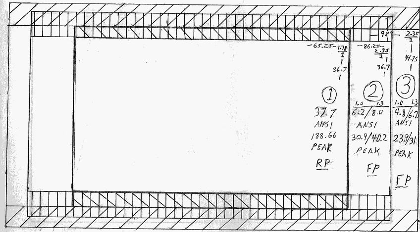

Well here is what I drew up to work out what my screen size should be. After looking at these numbers I think I would be pretty unsatisfied with the brightness of even a 1.3 roll-down. What you see is a rough representation of my RP screen and two FP screens representing the smallest size I would accept and the largest size I can hang on my electric assembly. The masked off area is the only thing I calculated for as these would be the A.R.'s most used. That's 1.78 for the RP and 2.35 for the FP, of course all you have to do is add 25% to get the Ftl. for the FP's unmasked at 1.78. I'm looking at MAYBE 10Ftl. for the smaller screen which still matches the height of the RP screen.
So, now i'm thinking about a torus. A torus would allow me similar or maybe even better gain than the RP and I could make it significantly larger, which would decrease the Ftl. some but would allow for a larger sweet spot(from what i've read so far). The only problem is I have no idea how to calculate the gain for a torus screen, given the different curvatures, sizes and materials etc.

i am guessing that calculating gain for torus screens only requires a correction factor when given the screen size of the torus and the flat screen. it will be an increasing correction factor with bigger screens
maybe projection screen manufacturers have graphs with those data.

Kiev commented:
> The only problem is I have no idea how to calculate the gain for a torus screen, given the different curvatures, sizes and materials etc. <
Bending a screen surface into a torus does not change the gain of the surface material. It just makes it more uniform... close to the same at the sides as in the central hot-spot. So you need to start with a higher-gain material, that wouldn't be appropriate for a flat screen, to get the benefits of a torus. Most look for a base gain of 3 or more.
- Tim
Posted: Tue Jul 20, 2010 5:51 pm    Post subject:
Yup, exactly. A torus just (ideally) spreads the hot-spot across the whole screen. A 3-gain screen material is almost unusable as a flat screen because you have such a bright hotspot in the center. Now curve the screen to reflect that hotspot at you from the whole screen surface, and the whole screen should be as bright as that hotspot was.

OK, so...
lumens = 240 * 0.57 (1.33 *2.35) = 136
Gain = 3.1 (Vutec Pearlescent White)
Screen Area =
A) 96 x 41 = 8' x 3.42' = 27.33 SqFt.
B) 108 x 46 = 9' x 3.83' = 34.47 SqFt.
C) 120 x 51 = 10' x 4.26 = 42.55 SqFt.
A= 15.42 Ftl.
B= 12.23 Ftl.
C= 9.9 Ftl.
Hmm... seems a bit low, but the 8' foot wide screen ought to be pretty sweet. By the way, do my numbers in the drawing look right?
