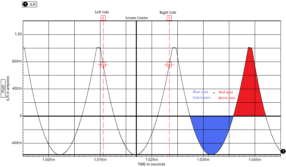

I think you will see that properly charged magnets will not focus perfectly in the centrer if the h dynamic coil is not connected to the focus amp. The h focus current is cap coupled to the h dynamic coil. That means that the current goes equally positive and negative. So the center focus will not be perfect unless the h dynamic current is negative when the center of the screen is being swept. This applies to Marquee projectors.
Scott

Posted: Tue Jun 29, 2010 1:20 am    Post subject:
Right Scott, I understand that . I meant that the coil not connected will still focus somewhat but not fully. With good focus coils its obvious to see the focus ability compared to one that has weak magnets while not electronically connected.
