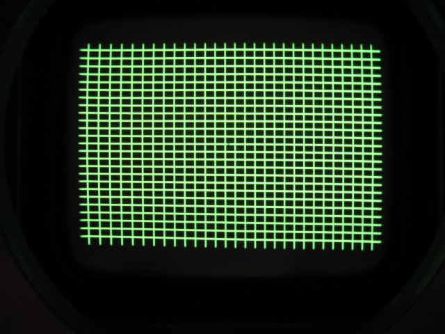

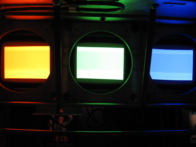

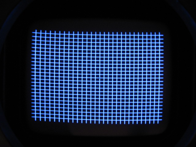

Before I head back down, there's another question from my ramblings I'd like to pick a brain about...
With all pincushion acceptable for the G&R the blue tube exhibits a bottom inward dip. Any idea why this particular tube is being rebellious? I didn't load the magnetics on it...just the 2/4/6 pole CPC. (which was visually nulled before installing). I'll try and snag a pic...Clarence I'm not but I'll try! Embarassed
Note: Rasters aren't leveled or centered yet. I only max'd them so far while I look into the blue tubes shenanigans
The new green to compare the geometry from the blue to. The red is similar.
 Filesize:  65.62 KB
 Viewed:  7512 Time(s)
Warped in at the top but other 2 tubes aren't. The bottom 'sags' too whereas the G&R don't.
 Filesize:  121.92 KB
