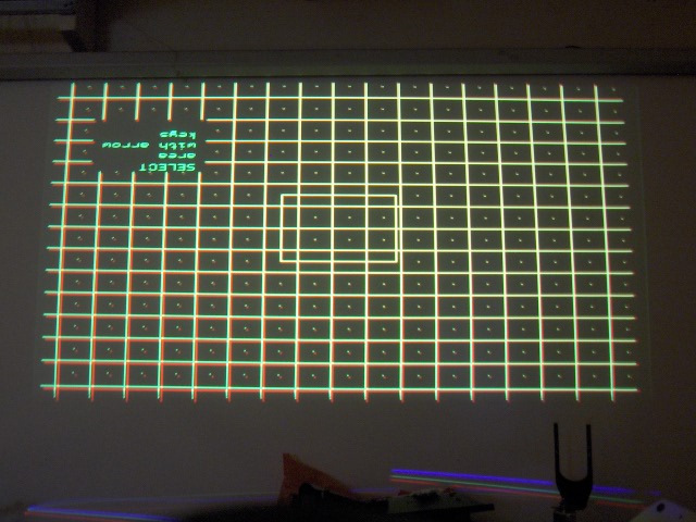

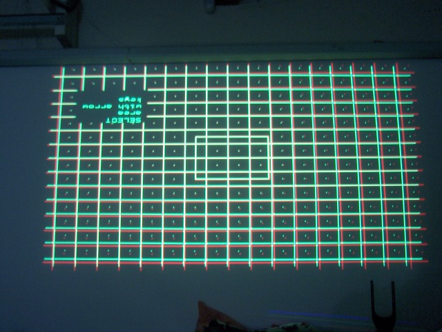

Posted: Sun Jun 06, 2010 11:55 pm    Post subject:
Pix of the original tube. Ignore the minor convergence issues, didn't do a perfect job, but you can see that the red flares all around at high contrast.
High contrast.
 Filesize:  108.96 KB
 Viewed:  2788 Time(s)
Low contrast
 Filesize:  106.33 KB

Are you sure you didn't disturb something while swapping the tube? The red test pattern of the old red looks fine along with the static convergence but the dynamic convergence is off.
Better run the $hit out of it before you send it back.
Posted: Mon Jun 07, 2010 12:39 pm    Post subject:
I am guessing that something in the electron gun is loose. As I said, I did a crappy quick job on convergence, as all I needed to see was if the red would shift.
Replacing the tube also solved the intermittent shutdown thing. It's been running fine overnight. Strangest repair ever, I think, since I can't explain that one..
