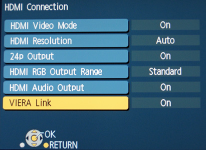

Craig on my BD-80 it shows "HDMI RGB output range". Is this the same thing?
 Filesize:  48.54 KB
 Viewed:  37718 Time(s)

Yes draganm, it's the same thing.
Part of the problem is that manufacturers of BD players and other source devices often do not use industry standard terms in their menus. Often for RGB you will have an option for "Lighter" or "Darker" instead of 0-255 and 16-235. In this case, you want "Darker" as this correlates to 16-235. You will find manufacturers that use other terms as well, but the right one to use is always the one that makes the image appear darker when switched.
Another term for HDMI color space can be "Enhanced" and "Standard" instead of 16-235 or 0-255. This one is worse because Standard is not always 16-235 or 0-255 and same with Enhanced. Often you need to work with test patterns to determine what setting you should be using. And the manual for the device will not help as it's explanation will not mean anything that makes sense.
Test patterns make it easy. If you can see blacker than black in a test pattern you can be pretty sure that you are at least on the correct setting for luma.
If you have the option for YCbCr you will get better color, but it is also easier because industry standard dictates only the 16-235 luma range for component digital.
However, I have found Denon and Marantz (Denon clones) actually have the wrong luma range with YCbCr and they use 0-255 incorrectly; WRONG WRONG WRONG Evil or Very Mad With these players there is a "PIC Adj" button on the remote that you must press while a disc is playing. In the menu that comes up with Pic Adj you will find an option for either "0 or 7.5 IRE" or you will see "Lighter" and "Darker." Again, select Darker or 7.5IRE if that is there...
...this is infuriating to me because there is no such thing as an "IRE" in digital space. Not only did Denon not follow industry spec here, they also used a nomenclature that is absurd and wholly inaccurate to depict what the player will do.

thanks, it took 6 months but I can finally nail down now why I couldn't get BTB with Moome card set to 16-235. On the Panasonic BD80, i'm betting "standard" is 0-255.
I'll have to try Enhanced with Moome at 16-235.
