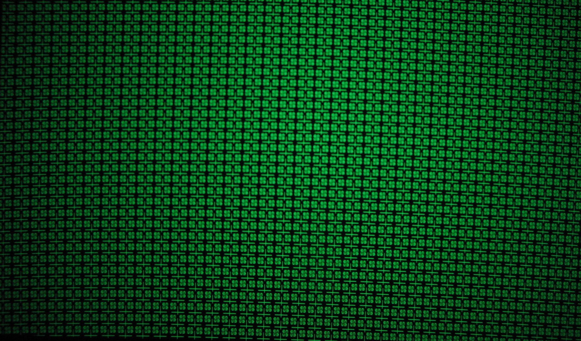

We touched up astigmatism, zone focus, and optical focus. It seems as though a "U" or "V" shaped area in the upper half of the screen will not focus as well as the bottom half. Contrast is set to 55. Please see the screenshot attachment.
Green Focus Pattern - Notice better focus at bottom center and sides.

Posted: Sun Jun 06, 2010 6:23 pm    Post subject:
Have you looked into the lens with sunglasses on to confirm this issue is on the tube face, and not an issue with Scheimpflug, which is an optical issue?
BTW, what contrast setting was that pix taken at?
Posted: Sun Jun 06, 2010 6:37 pm    Post subject:
I agree with curt. Looks more like an optical issue.
Curt it was at Contrast of 55.
Contrast at 55. It's not an optical issue as we looked at the tube face and the image matched what we are seeing on screen.
Posted: Sun Jun 06, 2010 7:00 pm    Post subject:
It's got to be the tube then. Can't see it being anything else at this point.
