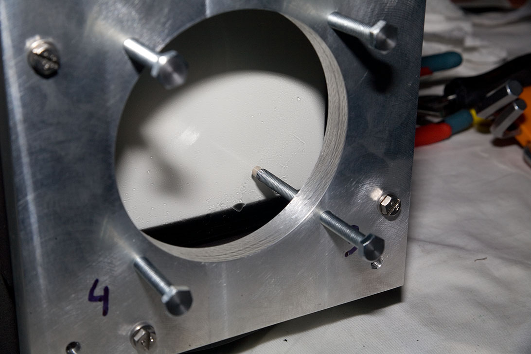

It's been a while since I posted anything in this thread. That's because I have been busy. Following suggestions by others I have designed a tool that can be used to glue the tube in the LC hardware with an accurately defined Scheimpflug angle.
Basically it is a plate of aluminium that can be screwed to the LC hardware instead of the C-element. In this plate four screws with a plastic tip are fitted that can be used to measure the location of the present tube. I can then take out the old tube and use these same screws as a reference/support when glueing in the new tube. Of course I can also make a small adjustment to the SP.
The picture, I think, explains everything.
Today I tested the system and was happy to see that everything fitted together as it was supposed to.
However, when I took my first measurements I found that the SP angle was quite different from what Barco's LENS programme predicted. The horizontal angle seemed OK, but the vertical angle was quite a bit off. I measured 0.75 degree, when LENS said it should be 0.45 degree. Since I estimate that my measurement accuracy is 0.15 degree at worst, this seems quite a significant difference.
So I wonder, how accurate BARCO actually glued these tube themselves.

Gerbrand, how do you prevent the bolts from twisting, screwing up the reference, I don't see any lugnuts?
Gerbrand
Joined: 13 May 2008
Posts: 199
Posted: Mon Jul 19, 2010 8:29 am    Post subject:
They do twist a little bit: I think the tip can move up to 1 mm sideways. This should add up to 0.1 mm accuracy, which is still a lot less than the discrepancy I found.
However, I will follow your suggestion and add a few nuts and see if it improves. This will also help me to lock the bolts at the correct length.

Indeed, you need to lock the bolts, by adding a bolt on top of the plate, so when you remove the jig from the housing the bolts don't twist, reducing or increasing the desired length.

Yesterday I remeasured the whole thing, but now with some nuts at the back of the plate. The bolts no longer moved or twisted, but the measurement result is just a little bit closer to the number expected from LENS. (0.65 degree instead of the expecteded 0.46 degree).

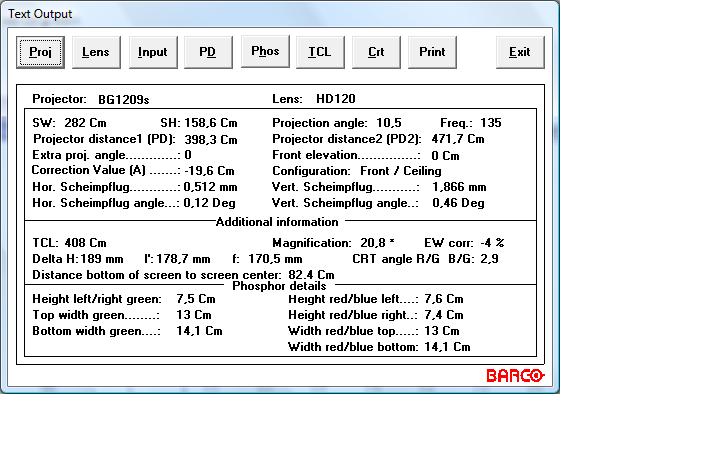

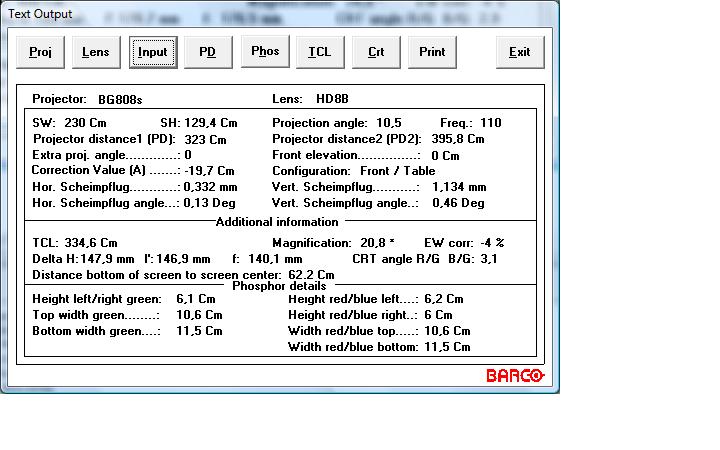

I think I nailed the issue: LENS is wrong.
The details:
Page 17 on the document Scott referenced, states that the SP angle is given by (here comes the trig):
tan SP_angle = n / m * tan(lens_to_screen_angle)
In this equation m is the magnification and n is the refractive index of the fluid between the tube and the lens.
If I plug in the appropriate numbers: m = 20.8, n = 1.478 for a 20/80 glycerine/glycol mixture and lens_to_screen_angle =10.5 degree I get a SP angle which is very close to what I measured initially: 0.75 degrees.
My suspicion is that the LENS program ignores the liquid coupling.
I can prove this by doing the same calculation for an air coupled system (BG808) and a liquid coupled system (BG1209s). I had to choose different screen sizes to get the same magnification because the tube size is different.
The result is shown in the attached figures. The SP angle is exactly the same in both cases!
So the SP is adjusted by Barco to the correct angle, only LENS is not to be trusted in these matters...
BR

LENS output for a BG808s with m=20.8
 Filesize:  61.48 KB
 Viewed:  4255 Time(s)
LENS output for a BG1209s with m=20.8
 Filesize:  60.93 KB
