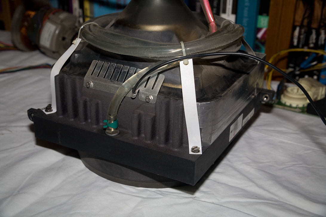

I recently bought a set of new P19LUGs from Terry and today I finally found time to start installing them in my 1996 BG1209s. This model does not have adjustable Scheimpflug. Instead it is fixed for a screen width of about 2.40 m.
When I removed the tube cover, I found a sticker on my original tubes saying "Special Scheimpflug corrected CRTs". So I suppose this means that something special has been done to these tubes to enable the Scheimpflug correction.
Now I have the following question: if I mount my new LUGs in this set, will I loose the Scheimpflug correction?
I have included a picture of the red tube + LC chamber below.
Thanks for your help,
Gerbrand

Before you remove the tubes from the housings - measure with c-element removed
the distance from the front of the housing to each tube corner. this offset will be the
flapping adjustment which will be optimized for a particular throw distance, possibly
listed on the PJ somewhere. Possibly you could make a jig using the old tube/housing
so that you can glue the new ones in at the same orientation.
G

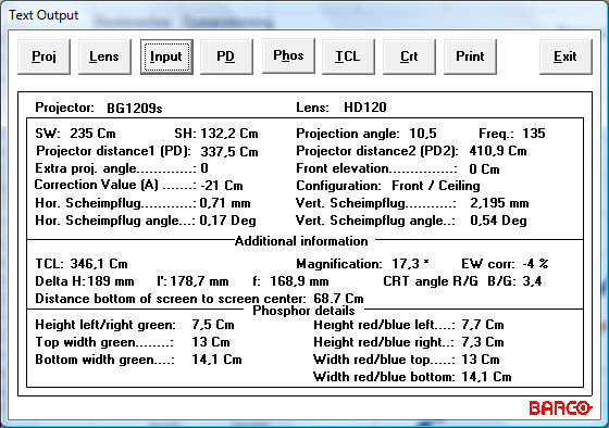

This is the the output of LENS for my set-up. As you can see the Scheimpflug for my tubes is actually not quite correct for the screen width I use.
After reading your thread about "poor man's lens flapping" I had one question: what reference do you use for the plastic distance holders. One side it is the tube face, but on the other side ? Is it something that holds the C-element or the C-element itself?
Thanks,
Gerbrand

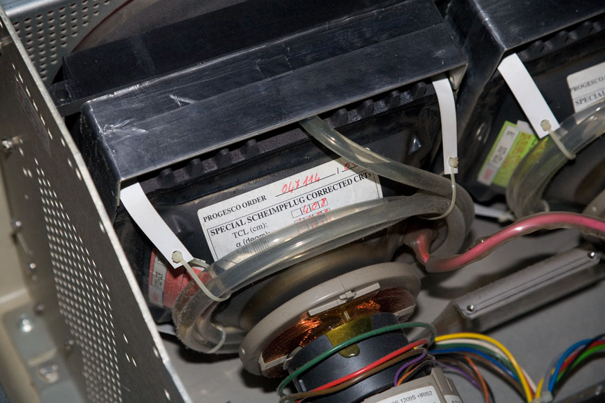

Posted: Tue Jun 08, 2010 7:39 am    Post subject:
Hello,
Yesterday I had a chance to take the blue tube out of the projector. When I posted a photograph of it (below) on the Dutch htforum, it was pointed out to me that I actually have LC chambers of a newer type than Ile. Mine are made out of cast aluminium and apparently do not have a flat surface at the back, that can be used to glue the tubes against.
Basically it looks like that trick with plastic spacers might not work.
The only reference plane I can really trust, it seems, is the surface that the C-elements are bolted onto. So I think I should go for the following option:
First make an Al plate that can be bolted onto the chamber instead of the C-element. In this plate make four threaded holes, that can be used for reference bolts. Basically I screw those bolts in until they hit the surface of the tube. I can then use the bolts as a reference for glueing.
Does this sound like a good idea to you or are there better options?
Regards,
Gerbrand

Posted: Tue Jun 08, 2010 9:02 am    Post subject:
I guess there is machined plane against tube face plate, that is now under rtv.
Gerbrand
Joined: 13 May 2008
Posts: 199
Posted: Tue Jun 08, 2010 9:24 am    Post subject:
I would really like to be sure about that before I cut the tube out of its housing. Does anybody happen to have pictures of exactly this kind of housing without the tube? Or would I be able to see this when I take off the C-element?
Gerbrand
