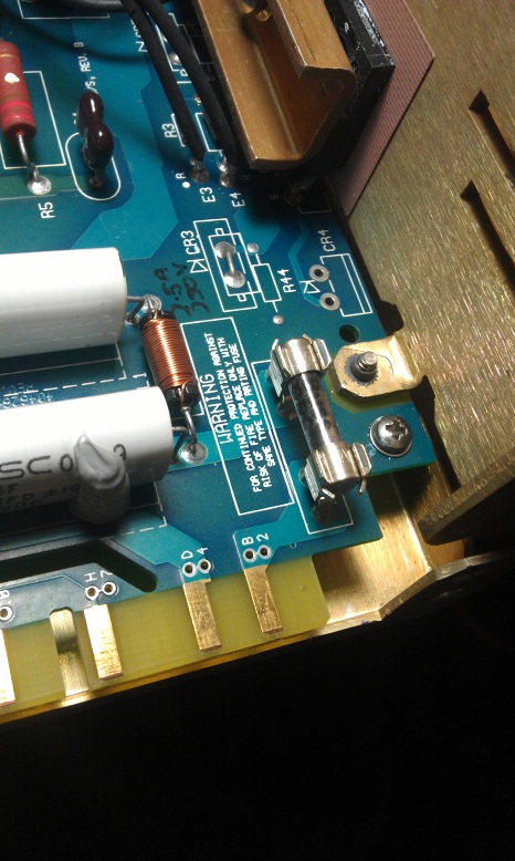

Posted: Sun May 26, 2013 11:16 pm    Post subject:
The fix lasted for EXACTLY 3 years... what a coincidence!
Now lets see if replacing the MOSFETS will do the trick again...
Greetings

Posted: Tue May 28, 2013 11:08 am    Post subject:
Greetings
It did! Thanks again for all the help three years ago, this time the rapair took me 30 minutes Thumbs Up
Greetings
