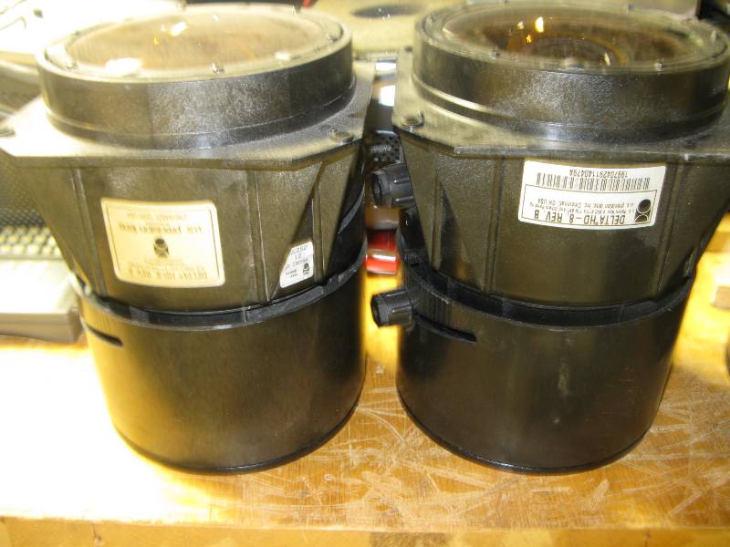

for HD8's, the older ones from like pre 95 have a gold sticker, newer ones have a silver sticker with patent information and a bar code
