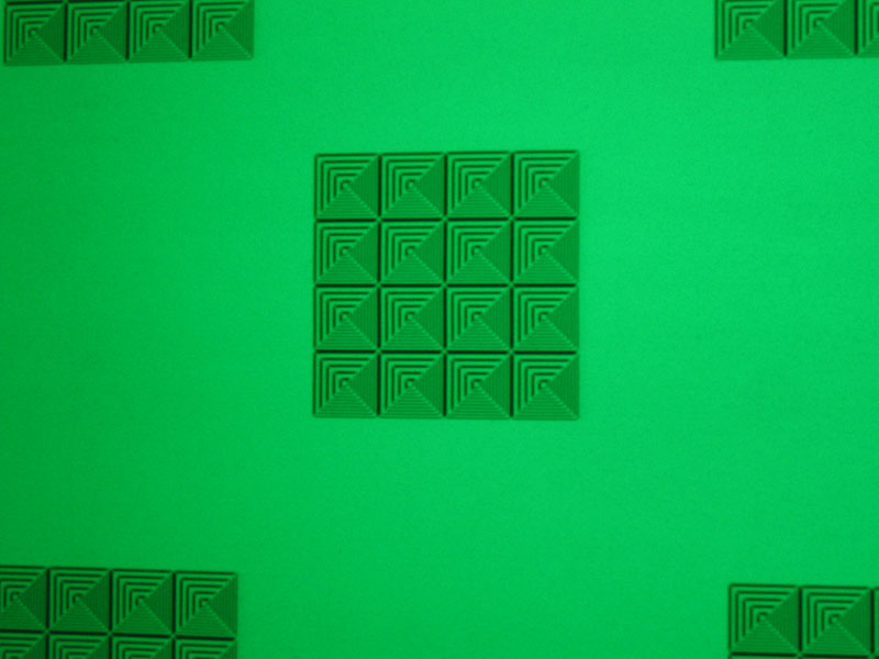

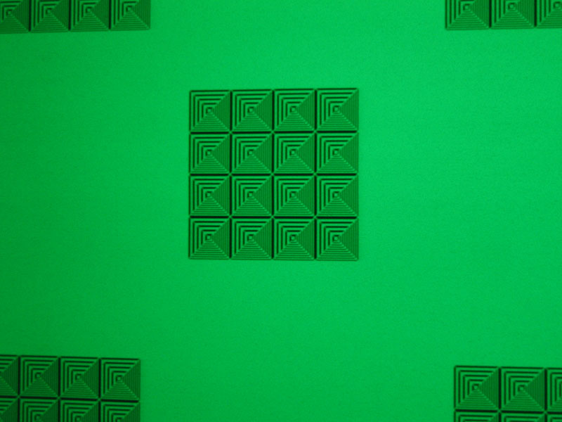

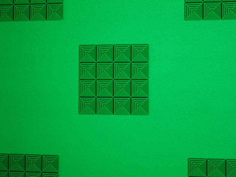

After reading this thread, now I think I understand why the set of HD10-GT17 originally came with my projector, have better focus than the HD10F set from a G90 I have.
My Marquee is a VDC 9500 Ultra from 2004. The picture looked really sharp but I was not able to get the same level of sharpness in all screen. First I checked if it was the focus on the CRT, but this was no the case. Center focus was perfect and corners focus close but not as good. For that reason I started to look for a set of HFQ-900 or HD10F from a G90. I was lucky to find a set of HD10F from a G90 from Curt. The sharpness I got with the HD10F set was definitely worse than the one I got from the GT17. Also contrast was better with the GT17 lenses. So I decided to keep using the GT17 lenses. Time after I found a set of HFQ-900 in Germany. This set focus better than the GT17, specially at the corners. It’s a lot easier to do the green geometry than with the GT17. Anyway, If I would have tested the lenses in my setup before paying for them, most likely I would not have bought them.
The reason that could explain this is the production date of each lens. The four first numbers of the serials numbers are:
HFQ-900 serial: 2002
HD10-GT17 serial: 2001
HD10F –G90 serial: 1998
The camera was on a tripod and the camera focus was fixed. Resolution 1920x1080p@60 from PS3 (no Scaler). Screen Da-Lite High Power surface. Projected size 220x123cm 16:9 format.

This is certainly a data point in favor of better revisions over time. Too bad they aren't published to show what they changed.
This just made a bunch of old lenses pretty worthless!

2 lenses of the same build quality and diameter, one being short throw and one being long throw.... the short throw will allow more light output and better edge focus. The magnification power changes across the surface of the lens. The more outer lens area you try to use the more difficult it is to achieve outer focus with a long throw vs short throw because of the magnification power.
This is why manufacturers have formulas. When you try to change from this formula by using more tube raster, it can be more difficult to achieve outer focus. The lens that was used for that model in production has to much focus loss as it moves away from center and the controls may not be capable of bringing the image into focus.
The formula is based on the ratio between the phosphor used and the screen width. The magnification power of the lens based off this ratio determines focal length.

The Delta Digital 260 design was last generic from 3M Precision optics in the US. They are made in China now. the D240-260's are a generic lens meaning it was made to work with more than 1 customer in mind. If your looking for a rev you wont find one because your not dealing with revs but tooling combinations. the D260 had 4 tools running 4 cavities each thats 16 different housing (you only par the cavity to itself to reduce variation), the mount was 6 tools at 2 cavities for all D240,250, and 260 models. The optic tools are many, but the tool ID and Cavity are on the ejector pin which can only be seen by taking the lens apart (don't do it the j-clips never engage as good as the first time you will get decentering).
Now the plant in China does ok, but they lost all the experience of dealing with the issues when they closed the US plant.
You may see some aging on a 10 year old lens because plastics are not true solids the will move over time, but the biggest colprate will be the C element that is attached to the CRT, swap that with a new one and you should see less field curvature because that's the C's job.
BTW, my source for this information is that I was employed and engineered the lens at USPL,CPL,3MPO. I work on D78, D240-270, etc.
Posted: Wed Apr 28, 2010 7:58 pm    Post subject:
You guys have to look at these HD numbers as model numbers. And something with the same model number can have different specs through the years of production.
Say like a Ford Escort, Escort (HD10L) being the model number. Now through the years the Escort is being built the model name doesn't change but the build specs do. So to say an Escort built in 1995 is the same as the one built in 1985, would be incorrect. You would have to look at the year it was built and then look at the specs of those years.
So the specs on the HD10L would change over the years but the model number would remain the same. This is where the serial number or manufacturers part number would have to be used.
I'm sure if you looked up the 1292 HD10L Sony part number and the G90 HD10L Sony part number, they would be different.
Remember you can have a regular Escort or a turbo charged Escort, but they are both Escorts. Just different equipment. And you have to know how to tell the difference between the 2.
If the G90 lens has better overall focus then the 1292 lens on the same machine, I would say they most likely were able to improve the focal change across the lens, meaning there is less of a change over the lens face. This would not be attributed to the AR coating. However a better AR coating would also be an improvement in light reflections and light output.
