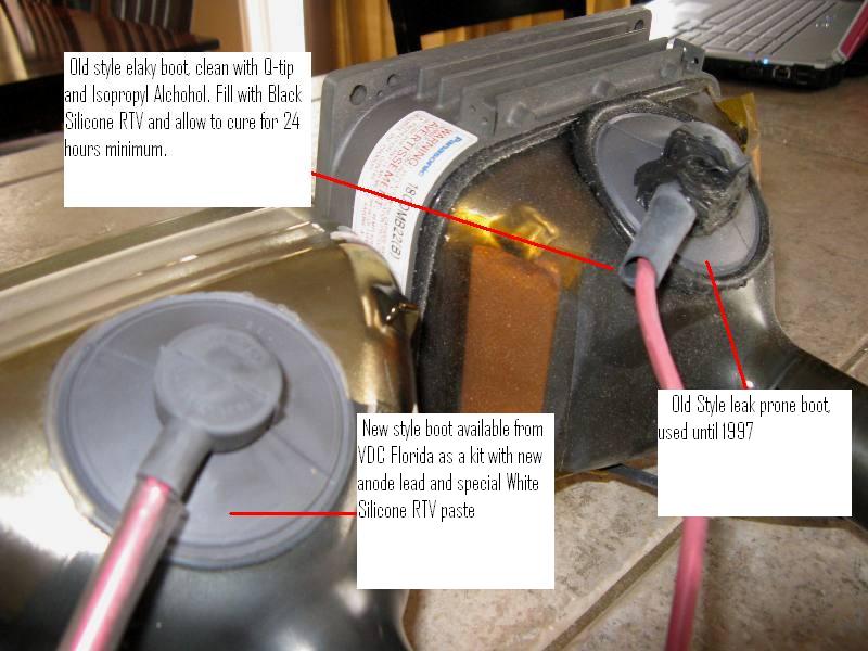

it's leaking at the boot and the HV is simply following the outside of the wire back to the splitter. If the HV wire has any carbon on it all that simply makes the leak that much worse since the soot is very conductive. Unfortunately VDC no longer sells the HV wires as a kit like they used to. however I have been suing both new and old wires for years now and I never get HV leaks. Like MArk mentioned, cleaning and re-sealing is key here

Posted: Tue Apr 20, 2010 3:23 pm    Post subject:
mhalsan wrote:
I had major arcing and corona problems, both at the splitter and at one of the tubes.
At the tube, I took the lead off, cleaned everything up and reassembled with new silicone. I cleaned the splitter and the HV ends w/denatured alcohol and let everything dry off. So far, so good.
Thanks, Mark
Thumbs Up
Posted: Tue Apr 20, 2010 3:28 pm    Post subject:
I agree, nothing wrong with the old style boot. I clean it, but also put a second layer of heat shrink over the existing heat shrink.
Just FYI, the boots are made by Hobson Brothers. I got all excited and researched that a few years ago when VDC stopped selling me new HV leads, and found out that VDC bought out Hobson in 2002 or 2003 I think. SO they have the monopoly on new HV leads. I did find a source of leads in the UK, and bought 20, but the leads and boots were very thin, I don't trust them on the 34Kv used in CRT projectors. For 18Kv black and white sets, no problem.
