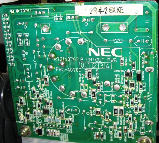

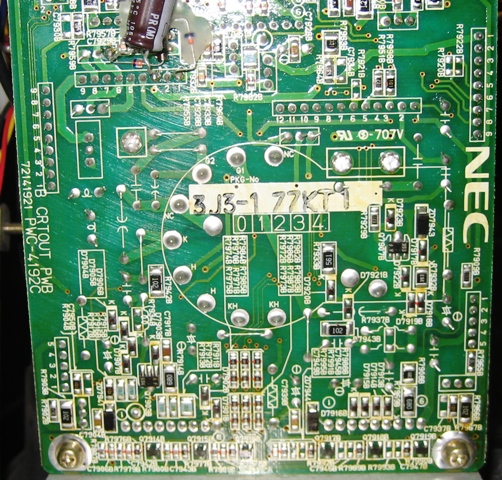

And that the 1101 number looks wrong to me - my 1101 has 72141921 PWC-4192B Inkstamp 3J3 neckboards (see images above).
Mark, my mistake about the 1101. The correct numbers are ..921.
1101 921
 Filesize:  221.64 KB
 Viewed:  4946 Time(s)
1100 702
 Filesize:  199.71 KB
Jerry

Yep, looking at that last image, of a 1st gen neckboard for an 06/07 tube, you need to mod the neckboard.

The later generation XGs have a push-pull neckboard with a pair of video output amps.
This, along with the LC, is the biggest change over the original.
