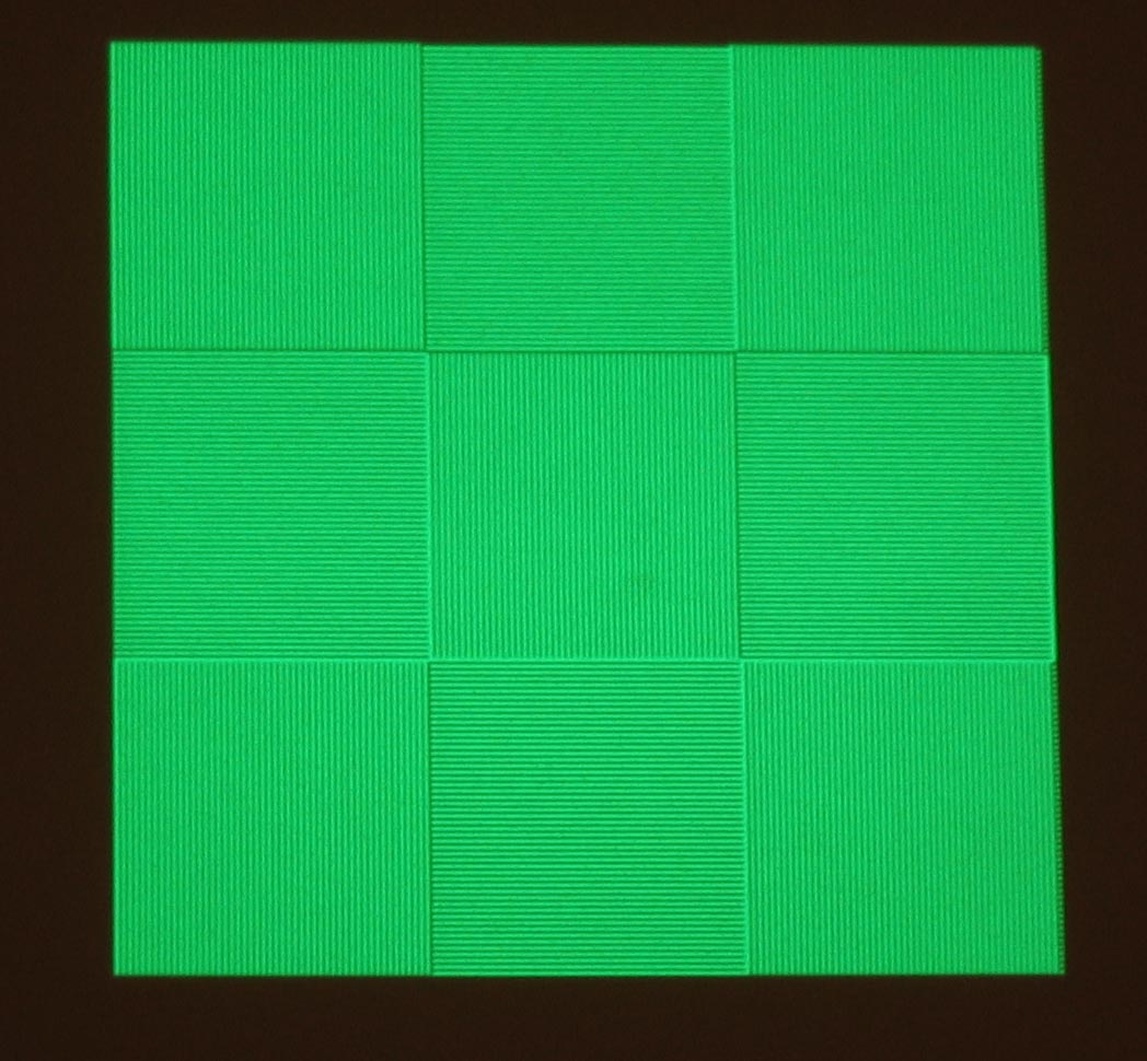

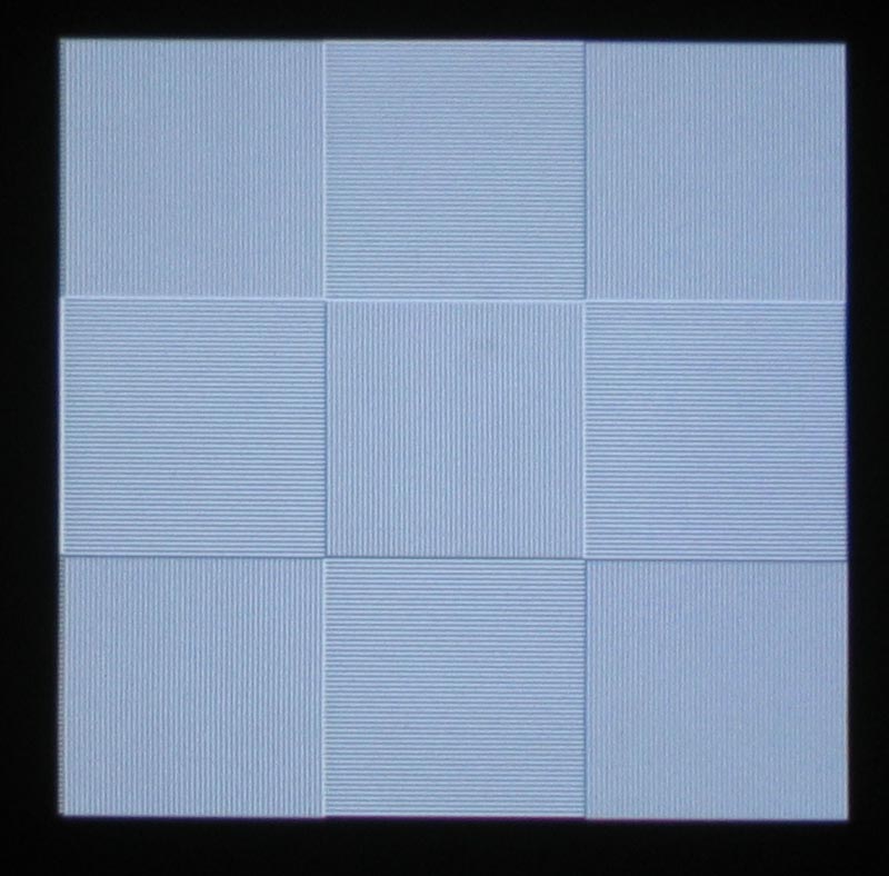

I changed the angle of the pots to be able to adjust them without an extender board. The only thing you need is a long screwdriver Laughing .
It is quite obvious the difference. After adjusting them I had to do the white balance again. It is also clear that if you adjust them more than needed you will get some high frequency overshoot.
I attached the test pattern I used.

Posted: Wed Apr 14, 2010 6:13 pm    Post subject:
Hi Diego, good idea with the placement of the pots. Just be careful not to break any solder joints for anyone else doing this.
I tried that pattern but it much easier to see using a single set of patterns with the complete set of one on one off,two on two off etc. Because it is against a solid background.
But the pot just turns and turns so you can keep turning ad watch it go in and out of the proper attenuation. When both one on one off patters are even in brightness or intensity then you know you have it right. Make sure you do one color at a time by pressing <color>1 for red,<color>2 for Green and <color>3 for
blue.
here is another trick to go even further to make sure you really have it nailed, use the Yellow,cyan,and magenta colors as well to tweak out the colors associated with those, so for yellow its blue and green, magenta red and blue etc. then look at the full white.

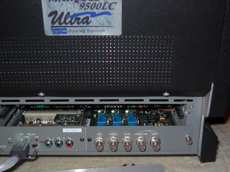

Posted: Thu Apr 15, 2010 12:43 am    Post subject:
I had a few moments tonight to look into the back of the pj and the vim looks exactly as was posted earlier. Also looked at some of Athanasios posts for when he received his longbows. I tried to put up some pics earlier but the link didn't work so one more time.
http://s802.photobucket.com/album/yy302/zulu_warrior_2010

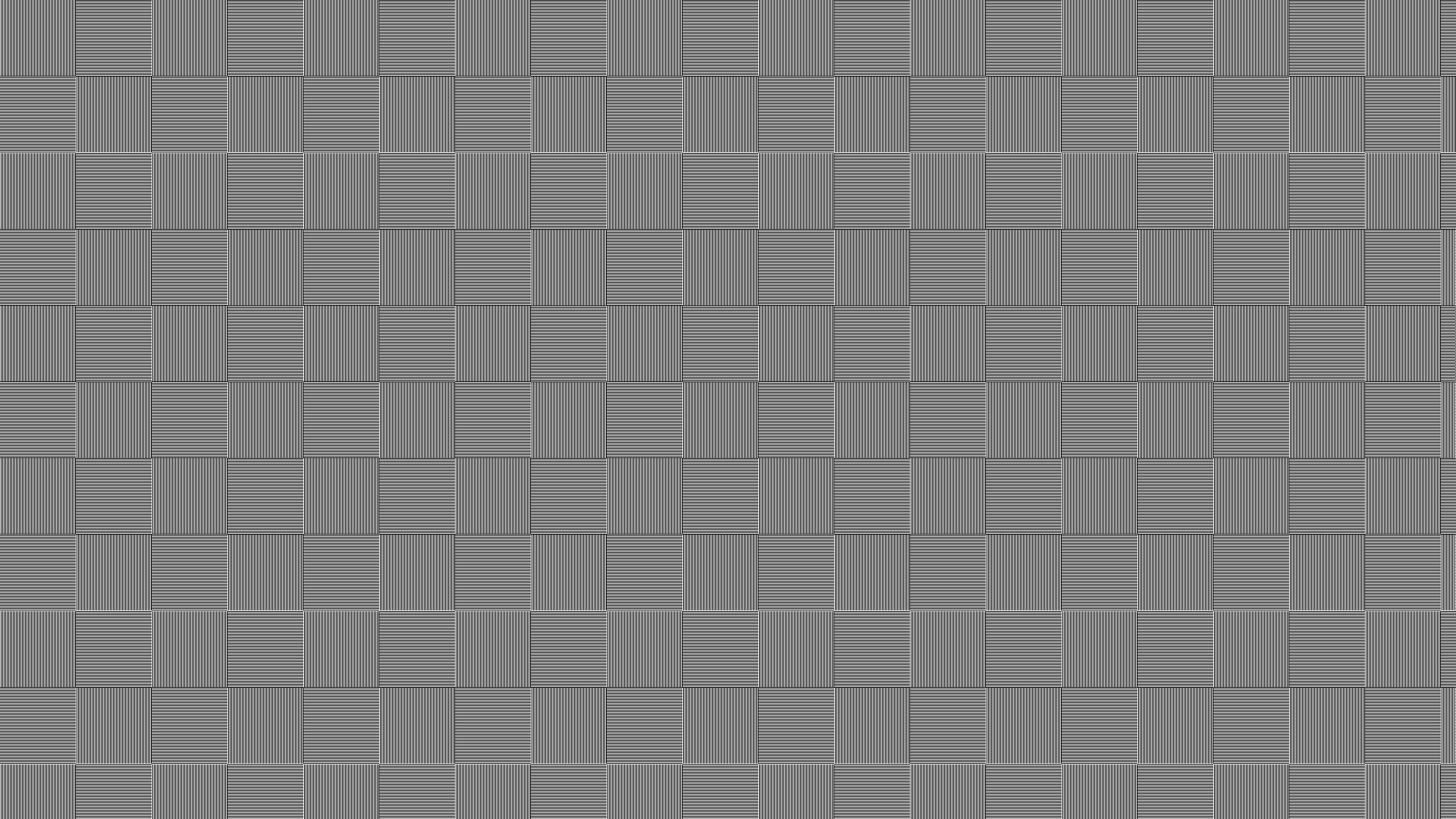

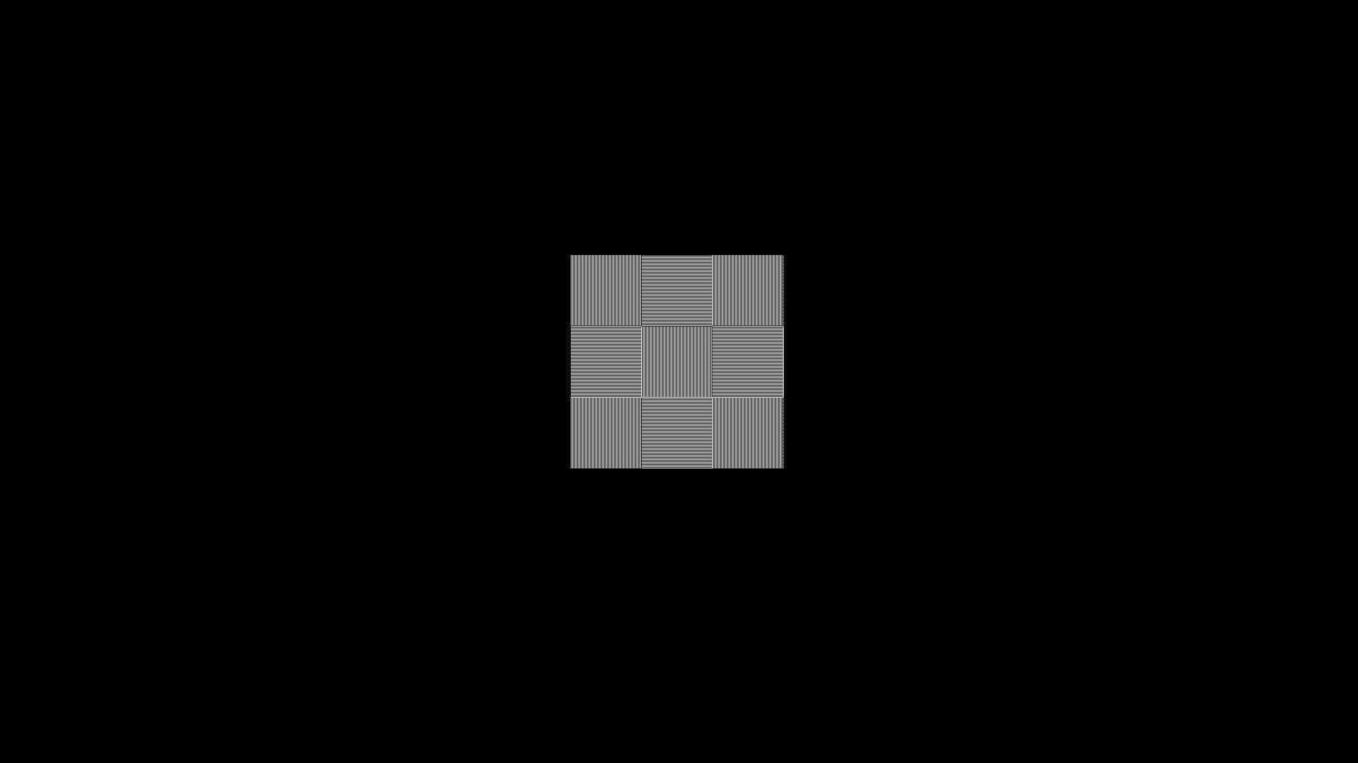

Posted: Thu Apr 15, 2010 9:46 am    Post subject:
blue.

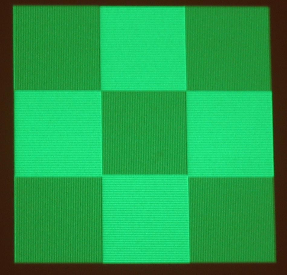

Hi Athanasios, you are right regarding the test pattern. I copied just part of the full screen one on one off pattern in a new pattern with a solid black background. If someone needed it is attached bellow.
Now I clearly see what is the target. Anyway I got some high frequency overshoot on green tube; maybe it is because this tube is a P43 type (looks much sharper).

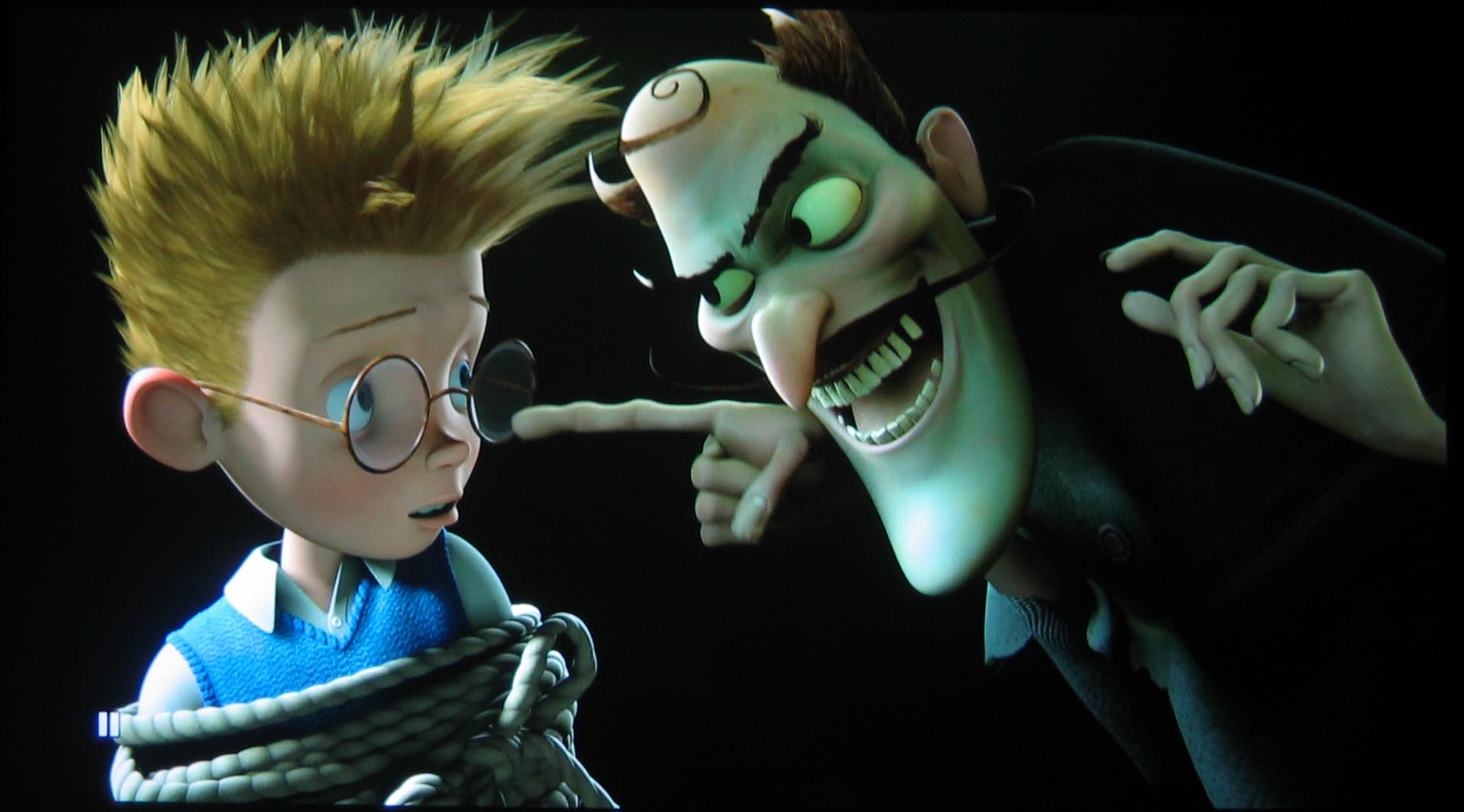

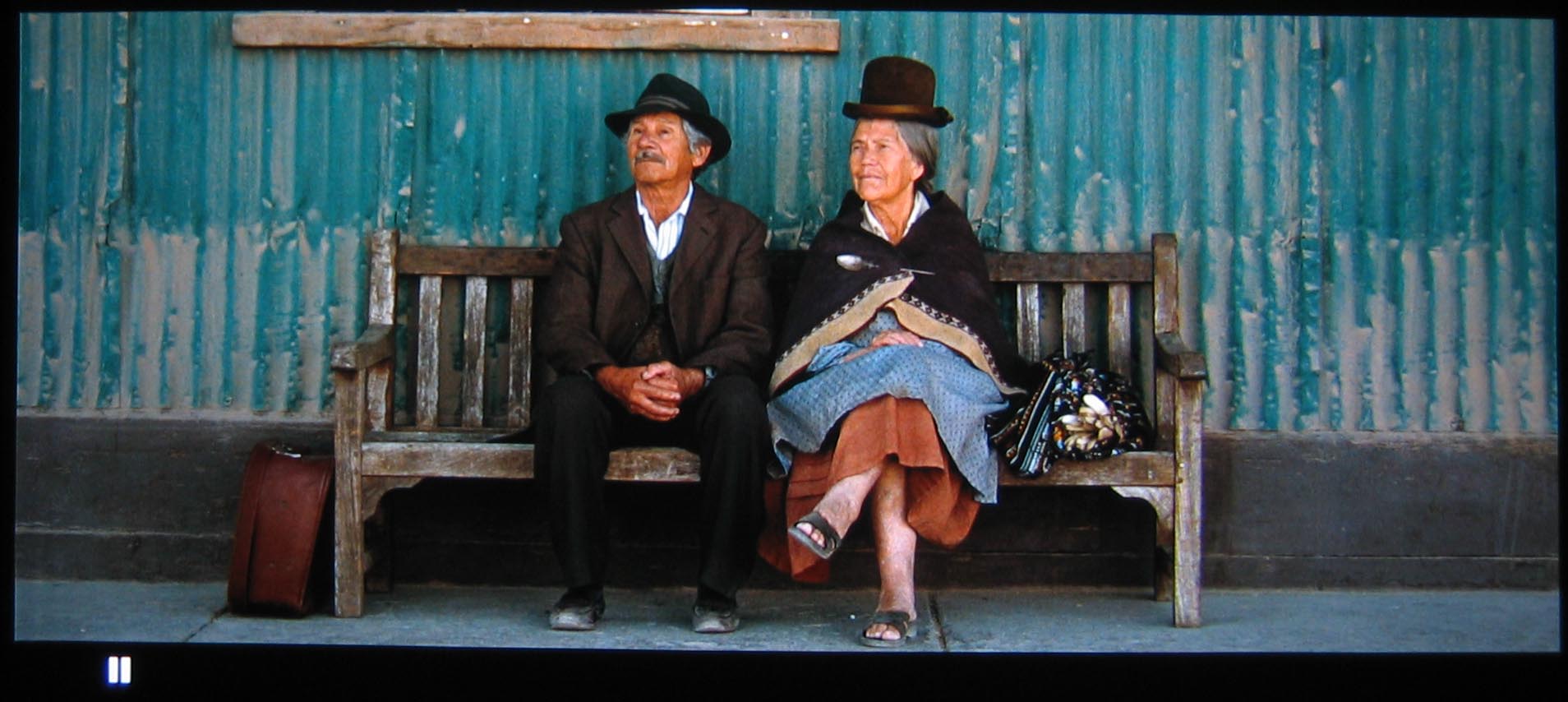

Some pictures of before and after:

Posted: Thu Apr 15, 2010 3:21 pm    Post subject:
Thanks Diego for the pics.
Before adjustment:
After Adjustment:
Sparky015
Joined: 12 May 2009
Posts: 1185
Posted: Thu Apr 15, 2010 5:35 pm    Post subject:
Wow, that's a huge difference! Are those at 1080P 60Hz?
~Paul
Posted: Thu Apr 15, 2010 6:06 pm    Post subject:
480P Laughing
