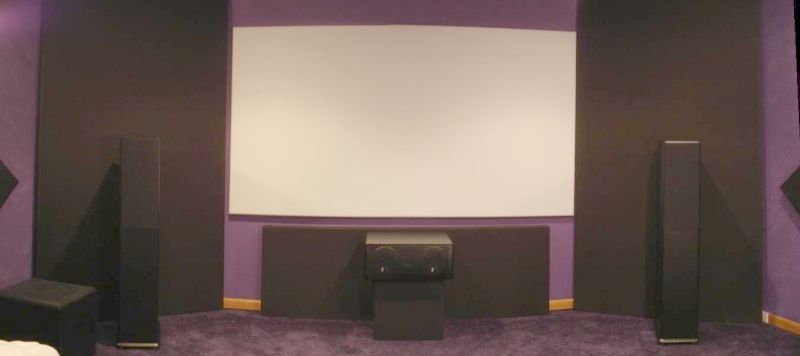

Posted: Wed Jul 07, 2010 4:06 pm    Post subject:
I've already got *major* bass traps in the room -- 4' x 8' panels of 4" thick OC703 in the two front corners. You can see them behind the fronts in the pic below. Those OUGHT to damp out bass problems a LOT. (The sub is at the left side of the picture, a few inches from the left wall.) The panel behind the center, and the side panels you can just see the tips of, are 2" of OC703 mounted 2" off the wall. Those are intended more for high-freq damping.
I got sweeps done once, but that was before I put the traps in.
I don't run the Klipsh as hot as your buddy because I don't like that boominess. But it means I don't get the kind of chest-massage bass that you get with a serious sub. But I'm not at all sure that something like the THT would do any better, or if it would show the same boominess because of the room.
I think experimenting with placement is my best bet. I need to mount the sub at my listening position and then go listen all around the room for the best sound.
