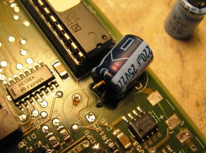

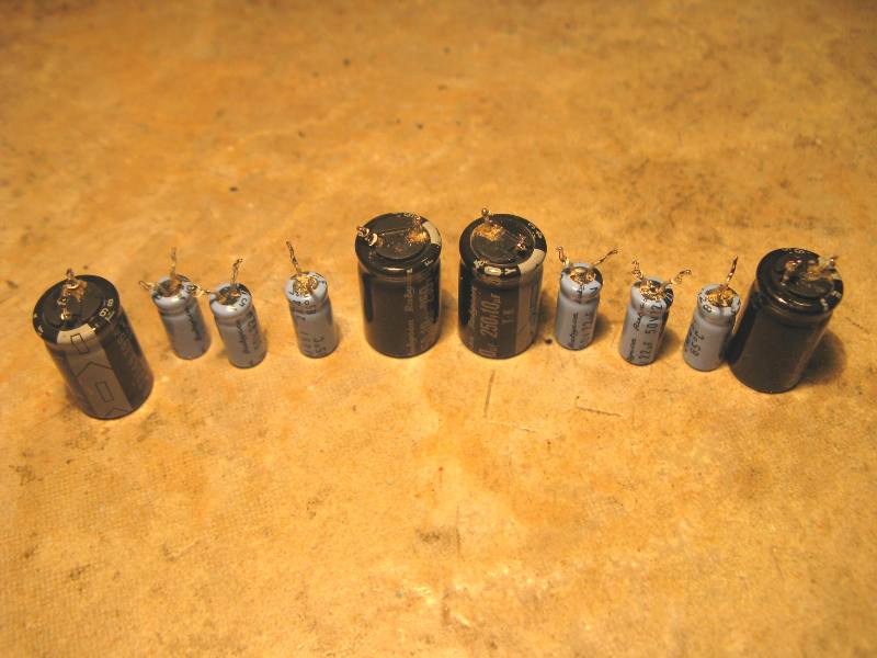

A couple of gems from recent Marquee board re-builds, CLM DPB and CVA. The DPB was in a machine that would experience random shut-downs.

Dragan, those are scary pix above. I don't think I've EVER had a bad cap on a Marquee. (thinking, thinking)..
wait, I have had a couple of shorted caps in the LVPS, but they were not electrolytics.
Seeing that pix above would make me suspect of the rest of the set. I'll bet it was installed in far too hot an environment, and the caps cooked themselves to death.
Posted: Sat Apr 03, 2010 5:13 pm    Post subject:
Well Curt, that makes two of us. You think the failed caps that were not electrolytics failed from an ESR problem..Mr. Green
Yep, that's very unusual. Looks to me to be external in nature, maybe heat or moisture related.
So one thing for sure, of all the Marquees he's been repairing over the years, the repairs must NOT have been cap related. Or should I have said electrolytic related..Mr. Green

out of approx 130 or so Aluminum EL caps on the marquee boards (not including power supply's), only 2 or 3 are 160C rated or what I consider "premium grade". The rest are 85C generic bottom of the barrel parts. The fact that they have lasted on average of 13 years for a typical 1997 set shows that Rubycon (Panasonic) simply had very good QC in place when they made these. I still feel , based solely on pic performance observations, that they are at or near the end of their life spans. Before anyone jumps down my throat that's simply MY OPINION.
What would be really interesting is to to take the next set I pull and bag them according to the board they came off of, then have Curt test them for ESR. Shouldn't take more than 20/30 minutes to do a general evaluation. You up for that Curt?
Last night I also thought about having Curt send me a set for the "HD mod's" work but I'm just too back-logged to do that right now. Hopefully later this summer as I would love to have someone who's had eyeballs on a thousand Stock MArquee's evaluate perecieved differences or improvements. I've been doing this for months now and since I test everything before/after the difference to me is very obvious but again, that's MHO.
