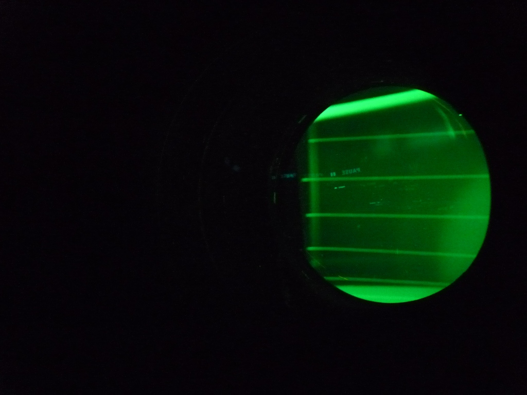

Hi guys,
My green crt acts up every now and then again.The last movie I saw it displayed diagonal lines on green crt only during the movie. I apologize for the poor picture.I had to take it looking into the lenses.The diagonal lines are just now appearing, before then the green crt would kind of flicker and the raster would be outside the normal screen area that it was setup for. This is the only problem Ive had since Ive owned the projector?
Any suggestions?
thanks

Posted: Sun Mar 28, 2010 7:31 am    Post subject:
Bad 2SK511 FET on the video amp board. If you are starting to loose one you might as well replace all three....
Posted: Sun Mar 28, 2010 7:52 am    Post subject:
Another thread.
http://www.curtpalme.com/forum/viewtopic.php?p=175335
If Curt is out I have a few new 2SK511 spares.
It could also mean the thermal heat sink compound on the FET has gone bad...
Posted: Sun Mar 28, 2010 3:20 pm    Post subject:
Or I can repair them. Replace all three, the other two are close behind.

Its doing it again. The green board retrace error. I swapped the green with the red and it followed it. It was replaced about a year ago. Any suggestiosn?
Posted: Tue Jun 21, 2011 5:49 pm    Post subject:
$35 incl return shipping to repair it. I've got 2 transistors left to fix these. DO NOT continue to run the set, you can spot burn the tube.

Posted: Mon Jul 04, 2011 7:57 am    Post subject:
Have Curt replace all three of the 2SK511 video amps with new ones...

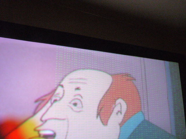

Posted: Sat Oct 22, 2011 10:04 pm    Post subject:
Curt,
Im late on mailing the bad board to you but wanted to know if this problem Im seeing also is the same thing, i.e. the chip going bad.
Ziggy
