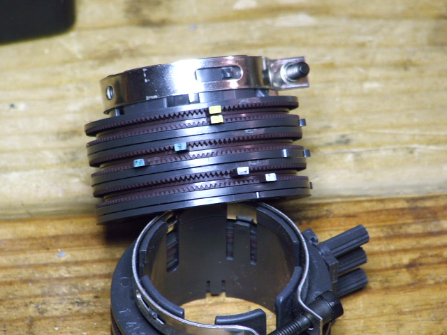

It helps alot to null the CPC rings before trying to align the magnetics. First, pick off the stuff used to seal the rings so they freely rotate. There is a good chance they will strip out if you don't. Set the rings to null by overlapping the little tabs, like the yellow ones in the pic. REMEMBER, the CPC rings are ONLY for adjusting the CENTER of the image. Ignore the sides and corners. The dynamic circuits correct those.

Setting doesn't matter when doing the CPC, you need to defocus and over focus to change the dots size and see the bright dot in the center. after is when you set overall focus.
Now in the RGB focus menu you can set to 50 is thats what you mean, but i set all to best focus i could even with incorrect CPC settings, reason is for the same reason Scott mentioned above, the focus magnets are not perfect,then i went back and double checked, it usually stays the same.
