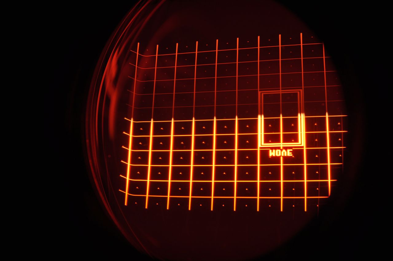

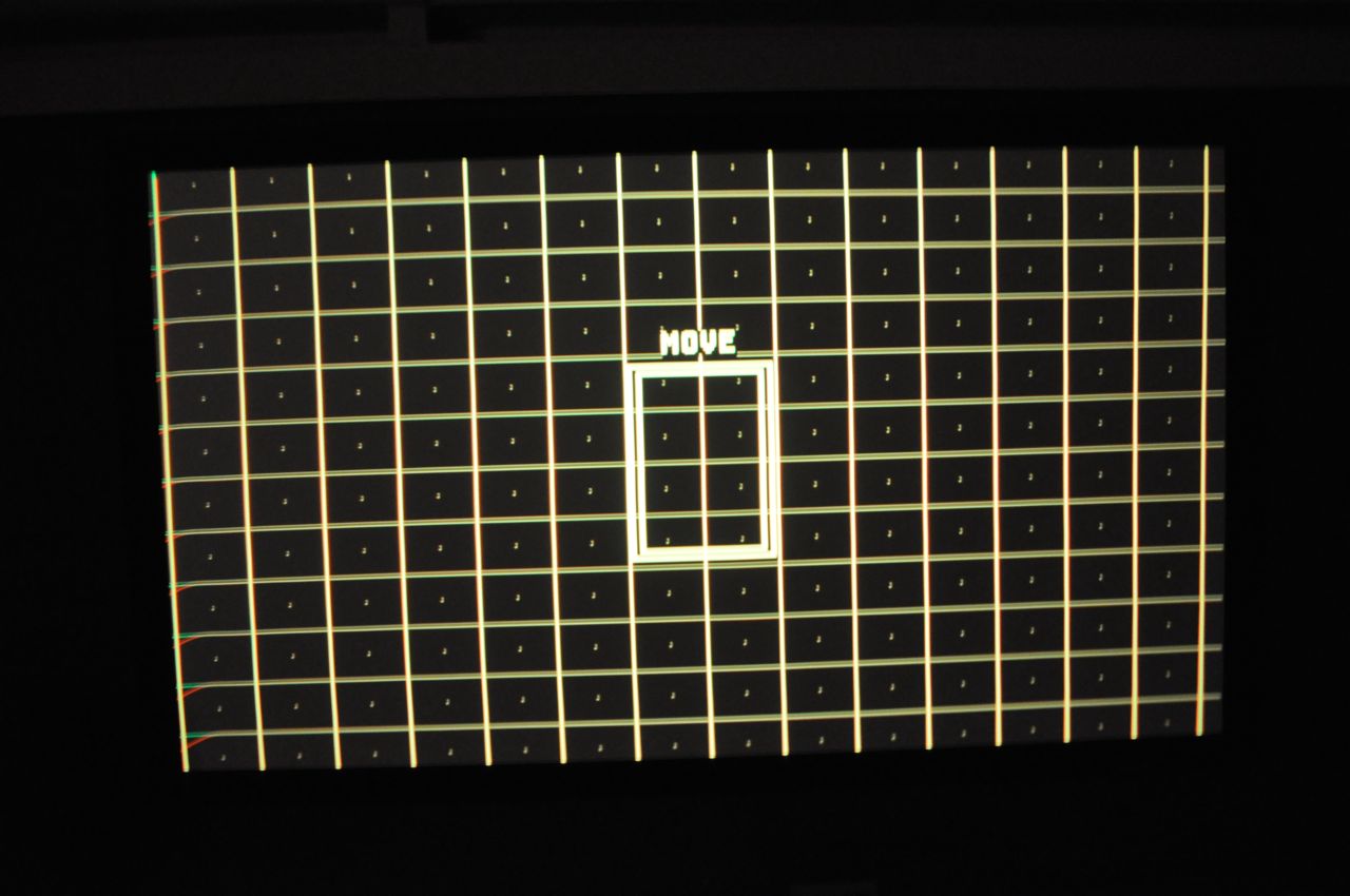

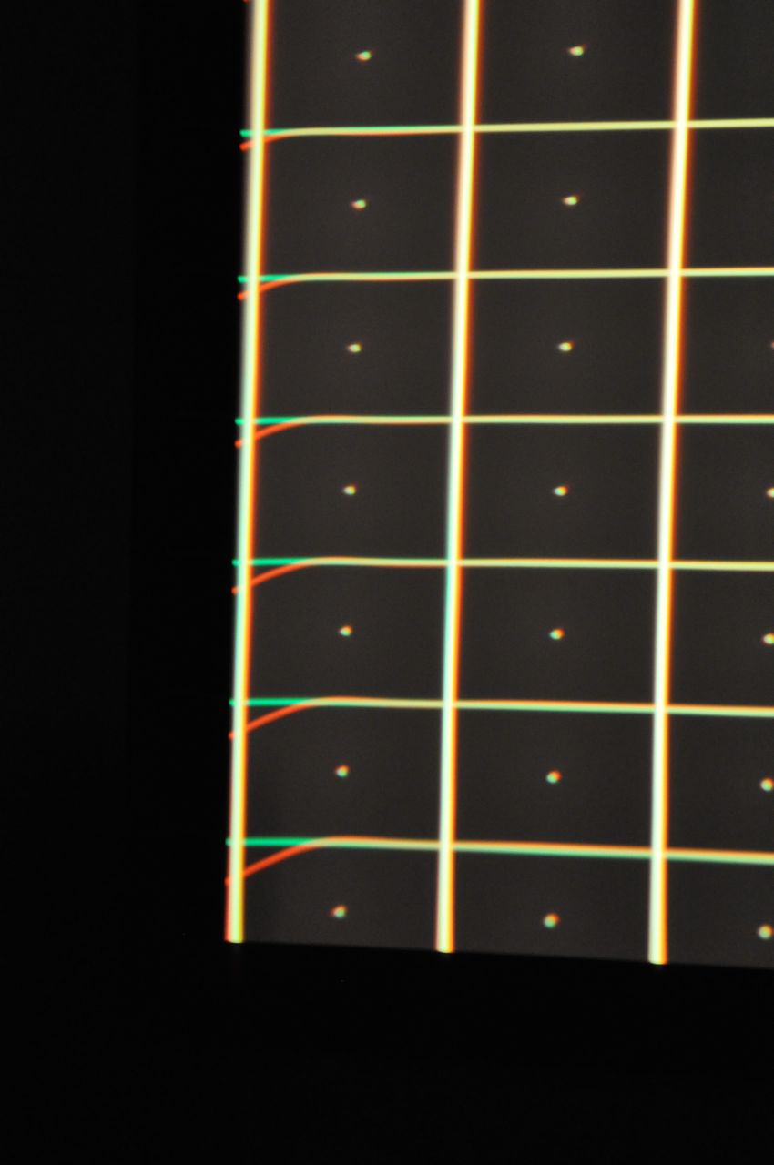

I read from one of your posts I should be using 1080p/60 and not 1080i so I changed it and the image is MUCH improved but I found there is a problem with the red set up. I've attached a few images so you can see whats wrong and how do i fix it. looking into the red lens it looks like the red is folded along the edge.
into the red lens - looks like a fold

close up

notice the red on the left edge
Your red raster is folded over the edge of the tube, that's from a poor set-up.
Also those grid lines are really fat. If that's the best focus you can get out of that machine it really needs some work, either electronically or set-up wise.. Maybe you can start with a basic set-up and go back through it for now and at least fix the folded red raster. I'll send you a basic set-up guide I wrote in a PM if I can attach it

Drags its a bit deceiving, I am not sure its folded over or just skewed up. With out a pic of the whole tube face i'm not 100% sure. But if it is then you need to go into mechanical set up and sift the red raster over so it matches the location of the green. then you'll need to swivel the entire red lens and tube to match the green.

That is the best focus I'm getting Sad when I was playing 1080i the lines were even thicker. I would like to go through you guide to fix this. I'll send you my email if needed.

Its not that hard Marcose. Just follow the mechanical set up guide in the help menu on the remote. You can look it over with out actually doing anything just to get familiar with what it is telling you to do. just follow the steps and you should get a nice picture. I guaranty the red tube/lens needs to be shifted over by loosening the two hex nuts and the 4 A bolts, then shifting the red raster over which can be done going through the Mechanical set up guide in the help menu.
Look it over, just keep pressing help to move to the next instruction Screen, if you want to go back a screen press recall.
its very simple

Ok, but is it going off the side of the tube face or is it just bending up on the flat part of the tube?
If so then it might be an off centered deflection yoke or convergence yoke. or you need to add more total pixel to the timings, one thing to try, go into the menu for pic and see what happens if you change the long and short retrace. you might cut off some of the picture but the convergence will be fixed on the edge.

[Ok, but is it going off the side of the tube face or is it just bending up on the flat part of the tube?
Athansios
It is bending on the flat part of the tube face. The raster is slightly off center by about 2-3mm only (as far as i can see)
retrace is set to short. when i set it to long the image is better but im cutting about 7% off either side of the image.
Yepp, thats what i thought if you went to long. The Marquees are very sensitive to timings. Even with a Moome card or HD fury you need to be able to add or delete pixel lines. This is where a Video Processor comes into play, Like the Lumagen HDP or HDQ series. You can play with the timings to fit the Image on the screen and still use long retrace which gives more room for the scan lines to not get distorted or to show ringing. But with VP you can more total pixels to give more room for image manipulation. you can still do it with out but it take lots of tweaking and messing around with raster placement.
Centering the red raster is the best way so far and then moving the physical lens. Do shift only the red raster you need to use the mechanical Set up Guide in the help menu. you can just move through all the other stuff till you get to adjust red grid, move it over a little and see if the grid with an image warps then.

I have gone through the mechanical setup on my proj and have got focus improved slightly, but I cant clean up the fold on the red tube, even by moving the raster around on the tube face the fold remains the same. A tempory solution, I have just enlarged the pic size by 3-4% to move most of the fold off the screen, im missing the anamorphic upgrade on my marquee so anyway im loosing 3% top & bottom. I think this is the best option I have right now if I want to continue to use 1080P, or I go back to 1080i and I get no fold and can see the whole image.
