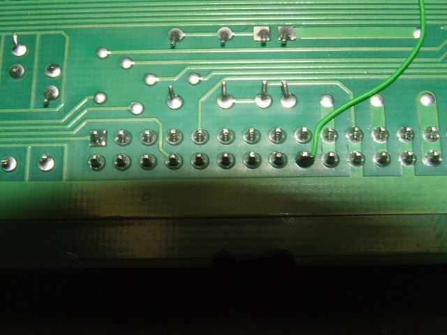

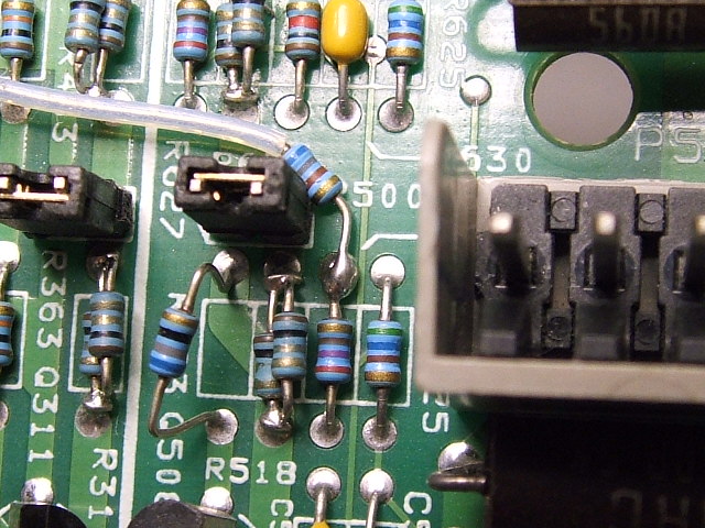

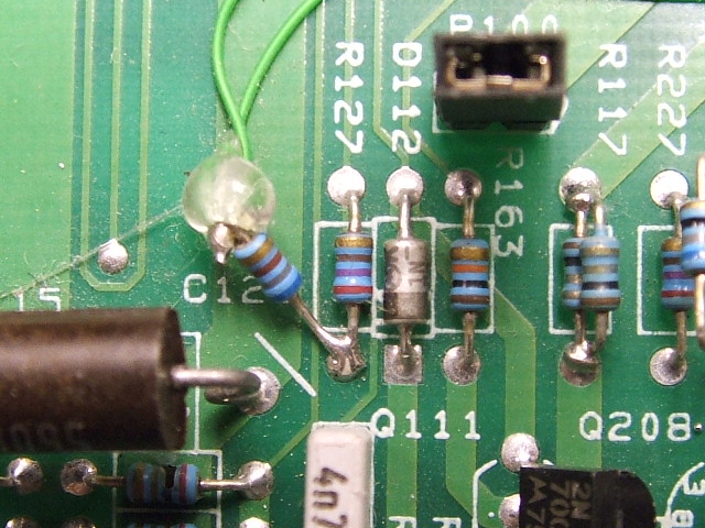

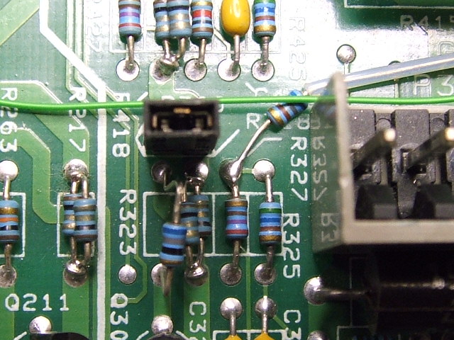

Received these info from Tse (Scott), who was, as usual very kind and helpful, and with his permission, I post them on the forum. It would be nice if someone could post detailed pics of CVA Ultra board...
Yes, the convergence amp has to have the flywire and three resistors to have the top and bottom pin/key.
This picture shows most of the mod:
http://www.curtpalme.com/forum/download.php?id=4382
The resistors are 680 ohm. 1/8 watt or 1/4 watt parts will be okay.
One resistor is for the red vertical amplifier. One end connects to R127, the end of R127 that connects to the center pin of Q112.
Another resistor is for the green vert amp. One end connects to R327/center pin Q312.
Third resistor is for the blue vert amp. Connect one end to R527/center pin Q512.
The other end of the three 680 ohm resistors connects to P7 pin 18. Look on the solder side of the circuit card and you will see one solder pad for P7 is square. The others are round. The square pad is pin 1. The other pins are numbered like this:
1 3 5 7 9 11 13 15 17 19.....................
x o o o o o o o o o
o o o o o o o o o o
2 4 6 8 10 12 14 16 18 20.................
I don't have a board to take pictures from. You might ask someone on the forum to post one to make what I have written clear.
Good luck with your mod.
Scott

More pics showing how to mod non ultra convergence amp into ultra version.
