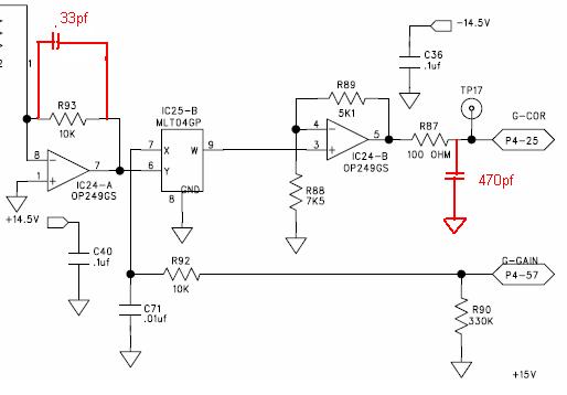

Well another Problem solved!!!! Thanks Scott for the Schematics. here is what i had to do.
I first looked up the data sheets for the Op amp that runs the zone correction, its a Analog Devices OP249GS. I first wanted to use the OPA2134 and tried it but then realized the DIP and SOIC have different pin locations!!! Oopps!!!
So i went to put the original back and reversed it, in a hurry haste makes waste guys, and I blew that channel(blue) so i decided to order a new one and still tackle the issue on the green channel.
I first added a 220uh inductor on the output of the G-Corr. that helped a little, so i looked over the data sheets some more and found an example that looks very similar to the CCM layout.
Well the way these are configured on the CCM is in a bipolar configuration , in the data sheet they suggest a 33pf capacitor on the first stage feedback. I did not have any that value but i do have tons of 100pf silver mica caps.
I added one and it really helped!! then I added another to get the value as close the 33pf so two 100pf in parallel
make 50pf. Now the brighter three or four vertical lines are gone!!!
Data sheet diagram, this is different pin layout than the CCM's but it workes the same, also the CCM has an extra chip
stage between the two OP249 stages, that is for the Gain.
here is a diagram of what i did on the Green channel, i found it easier to add the caps on the under side across the resistor.
So once I get the other chip and replace it i'll do the same for the other channels.
EDIT: Thanks Jarmo for catching my mistake, I changed the parallel 100pf caps to three in series to get the 33pf value.
But I Am going to order 33pf caps.

Hmmm, Interesting that, that solved part of the problem.
I would be interested to see the schematics, I saw a couple of improvements over the original design,
but also a couple of issues that were not an improvement.
Schematics would really let me see why issues were not solved.
Glad you saw an improvement, more work still to do.
Cheers
Steve
make 50pf.
Hmm. That 100p+100p parallel makes 200p.. Put those to series and you get 50p, three in series and you get 33,333p

Oops!!!!! Your right Jarmo!!! When I get home tonight I'll switch it.
I must have the holiday chaos on my mind!
I still need to get 33pf , three 100pf's in series will
take lots of room!
Merry Christmas!

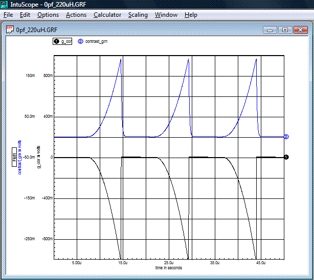

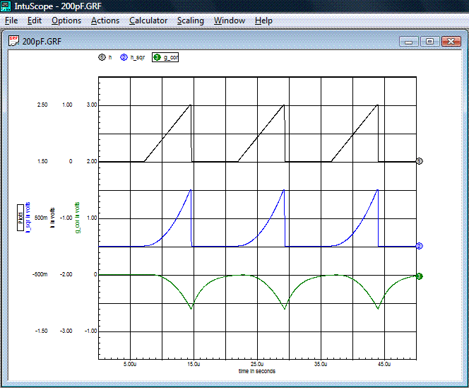

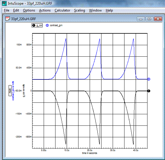

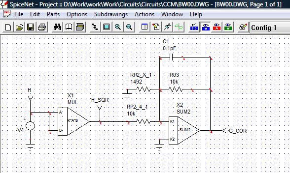

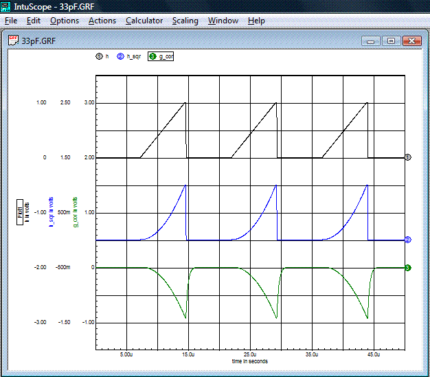

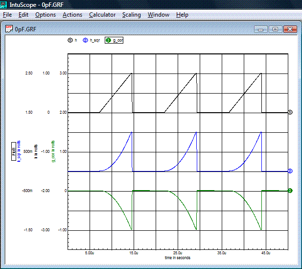

You have to be careful when adding filters for noise that you don't also filter your signal. Attached is a simplified circuit of part of the CCM. The signal being simulated is the right side modulation. The right half of a horizontal freq ramp is input. That is squared to get the proper right side parabola and applied to the inverting output stage. You want that signal to maintain fidelity through the rest of the circuits. Adding 33pF doesn't look too bad only changing the signal a small amount. With 200pF across R93 you have a signal that is much different from the original.
Scott
 Filesize:  70.17 KB
 Viewed:  7479 Time(s)
 Filesize:  23.57 KB
 Filesize:  24.01 KB
 Filesize:  24.14 KB

Posted: Sat Dec 26, 2009 8:17 pm    Post subject:
Thanks for the Info Scott. I only am adding the 33pf to the G-Cor in the very last stage of the CCM, i am not going to change the H-Sqr or the other signals on the CMM unless that stage is similar to the one from the data sheets, a bi polar layout.
One other thing, I first used the 220uh inductor then the caps, can you add the inductor into the spice program and see what the results are, that is if its needed or not. Now looking back its hard to tell visually if its helping at all.
I did notice one thing here are the details, I have the right PJ with no CMM in it right now, and the other I have the Blue channel not working(blown OP249 i think) and the correction caps on the green and the red is left alone for now, but when i start both PJ's up for the blend they have perfect convergence from a cold start and even after they warm up. Can the CMM's affect convergence till the PJ warms up or could this just be a weird coincidence?
Also if you leave the setting for zone contrast at 0 and scope the corr signal it has lots and lots of noise and it also bounces the trace. After the cap was added the noise was lowered but still a lot but the bouncing remains but is a little less with the inductor, any ideas about that?

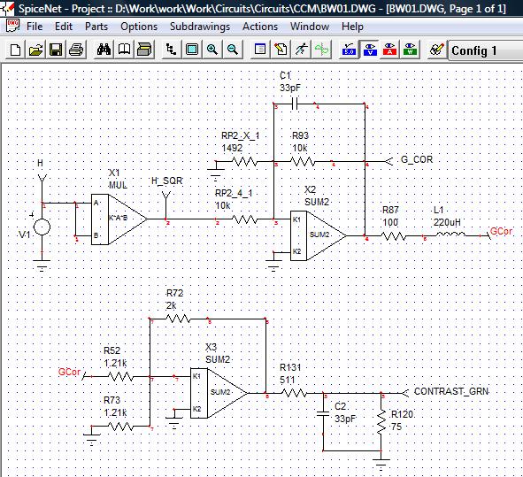

Posted: Sun Dec 27, 2009 12:03 am    Post subject:
Circuit with VIM section added. You can see some filter action with the 220uH in series with the g-cor signal. Even with both 220uH and 33pF the filtering isn't horribly excessive. This is at 68kHz. Might be too much at 150kHz.
Scott
 Filesize:  107.54 KB
 Viewed:  7446 Time(s)
 Filesize:  23.61 KB
 Filesize:  25.98 KB
Thomas Jefferson

Thanks Scott, I did see the same waves on the scope while adding Adjustment, the waves also change depending on which way from 0 you go up or down. However they are not as clean as your spice model , they are full of noise spikes. the filters clean it up a bit but like your model's scope the amplitude does get lowered a bit.At no adjustment where the Corr signal is suppose to be flat there are small bumps after adding the filters, before they were larger and more of them. As long as I see the lines in the image gone i'll leave it as is. i wish i knew a bit more on using the spice program. which one are you using? i know a few of the Chip makers have free programs for download, i tried with the one from Ti i think but never fully understood it.

I Did some more testing and found I could totally eliminate the bars with a cap to ground from the X-COR output.
I tried 470pf first and it worked great but only had 100pf and smaller values to also test and those did not work as well or at all.
I will try a 220 PF EMI filter, it has a center tap that goes to ground and the cap would go across resistor R87.
Id like Scott to run that through his Spice program if possible. I wish I knew how to use that thing and wish they made a MAC OSX version somewhere.
I'll try to post some pics of the before and after wave form, there is a ripple in the signal but on screen it looks good, not sure what that ripple is doing to the image or signal.
