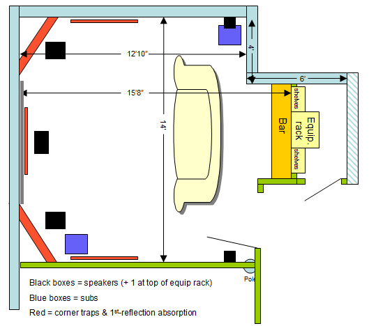

I've always been a bit disappointed by the low end in my HT sound. When there are explosions &etc it goes "boom," but nothing like the kind of visceral response you get from a really good clean deep subwoofer. When I watch scenes like the White House getting nuked in Independence Day, it almost seems more like a rumbly crackling sound than a bowel-churning KABOOOM.
I originally had an Onkyo HTIB -- cheap, but it did the job and it got me started. Since then I've upgraded my fronts & center (AV123 x-mtms & x-cs Encore) and my sub (from the 10" Onkyo sub to a 12" Klipsch KSW-12). The KSW-12 might have helped a little -- the specs say it goes down to 26Hz -- but the bottom is still pretty anemic.
I've calibrated the levels on the sub & other speakers. I can crank up the sub amp but then it just gets boomy.
I've got large (4'x8'x4" OC703) bass traps in both front corners. Currently the sub is next to one of those -- see pic. (Ignore the blue sub box in the rear right corner -- that was the Onkyo sub and I've since sold it.)
I'm wondering if further improving the sub (short of something really serious like an SVS or Hsu) is likely to be a dead end? Would a better receiver help? I currently have an Onkyo HTR510. I keep thinking the receiver doesn't affect the low end that much -- it just splits out the LFE signal and the sub's amp does the rest. But...
Eventually it would be nice to get a new receiver to gain HDMI inputs and proper HDMI sound processing. But it would be nice to have some more satisfying bass too. If I'm going to put money somewhere, should it be the receiver or a much beefier sub?
Help?

I have the same problem, but my issue is room related, not equipment related.
I've got 3 X 12" in a Tannoy cabinet, capable of 1000 watts, and I'm driving it with 300. Should be plenty of bass, but there's far more on the second floor of the house than there is in the theater room, go figure.
Over the holidays I plan on spending a day in that room, running more AC for one, as everything is run off 1 15 amp outlet(!), and I'll check phasing and will do some real time analysis, but I'm sure my problem is speaker location and lack of bass traps. I really need to do some reading about room treatment and acoustics.
Try different locations in the room for the sub.. Most subs have a phase inversion switch, try that as well. If the sub is a bandpass, that could be your issue, I've always found them to be boomy, and like direct radiating subs much better.

I *think* I tried the Klipsch in the rear-right corner, where the other blue box is in that picture. I know for sure I tried the Onkyo there. (Those are the two locations where I've wired the LFE connections. Currently I drive some bass shakers from the rear location.) That's really the only corner that's available, since the other 3 corners have bass traps or a door in them.
I didn't notice the bass being any better that way. I've never experienced **ANYTHING** like the "rush of wind" effect with my sub.
Curt, bandpass vs. direct-radiating?? I don't know which the KSW-12 would be. Can you tell from the spec sheet? It's a down-firing 12" in a bass-reflex cabinet.

Posted: Fri Nov 06, 2009 6:26 pm    Post subject:
Your graph was not there when I posted last, I am going to make some assumptions here so, the door to the theater is always closed when movies are being watched, 2 that down firing drivers actually work as intended [IMO I don't think they do} so just try moving the sub closer to your screen, or try these 2 techniques.
http://www.audioholics.com/tweaks/speaker-setup-guidelines/subwoofer-placement-guidelines
http://www.audioholics.com/tweaks/speaker-setup-guidelines/crawling-for-bass-subwoofer-placement

Posted: Fri Nov 06, 2009 6:36 pm    Post subject:
That first article mentions concrete walls/floors causing boominess, which is definiately a problem in my HT. The blue walls in my diagram are concrete, as is the floor; however the walls have wallboard mounted on 4" studs, with insulation behind them, so hopefully that mitigates that problem.
I haven't done the "put the sub in your chair" test yet but I should.
I've never quite understood the "put the sub in the corner for max output" advice. I don't need to *maximize* the sub output -- the sub amp is currently set at 3 out of 10. I could move it somewhere else and compensate with more volume. Instead of just making it louder, I want to increase the pantleg-blowing bass Smile without the boominess. Maybe the "sub in the chair" test would help me find a better location for that.

Posted: Fri Nov 06, 2009 6:40 pm    Post subject:
Yep, I don't get the corner thing either, it goes against everything I read, but, it sounds great this way for me, and feels good too. Thumbs Up

Posted: Fri Nov 06, 2009 6:41 pm    Post subject:
Now, for comparison... Your KSW-12 is spec'ed down to 26hz, but probably doesn't offer much usable below 30hz, and has a 105W amp.
Well, 105W continuous. I would think most LFE effects are very transitory, and the 440W @ <1%THD figure would be more applicable? Though 1% THD is probably pretty nasty even for a sub.
To answer your question about your AVR... No, unless something is misconfigured, you shouldn't need to replace it to improve your bass. Your right that it's basically mixing the low-pass from your mains with the LFE and sending it to the sub.
Ohwell. So much for getting HDMI inputs in the bargain. Smile
DIY is possible but not my first choice. I don't have the tools to do proper DIY. I have a friend I could possibly prevail upon but I don't talk to him much these days. I think the last two times I saw him were to borrow his shop for another HT project, and to borrow his bandsaw for a project for my kid. Embarassed What design would you use if you tried DIY?

Posted: Fri Nov 06, 2009 7:02 pm    Post subject:
That *would* be simple -- sounds like you just put 'em together. Wonder if they're any good? They've got a 250W 15" for $285, and a 1000W 15" for $750. I gotta think 250W would be enough for my small room! Surely 1000W would be massive overkill?
There are some used subs on CL in driving distance -- mostly Velodyne, some others:
Velodyne DLS-4000R, 12", $450
Velodyne VA12bVX10 12" AND 15"??, $250
M&K MX-150THX dual 12", $600
Velodyne FSR-15, $550
...but I'm wondering if a better sub would help, or if I have room problems that a better sub wouldn't overcome? Even with my corner traps &etc?

Posted: Fri Nov 06, 2009 11:20 pm    Post subject:
I'm seriously considering this, Greg:
http://www.edesignaudio.com/product_info.php?cPath=2_136&products_id=849
It looks pretty similar to the A7s-650, so it should be flat down to ~17hz, and down 3db at 15hz. In-room, they saw the A7s-650 is good to almost 10hz. Wow.
Between throwing my old M&K's on craigslist, and selling the set of really nice new-in-box MB Quart drivers I have on the shelf, I shouldn't have to dip into the kitty so much, and after a weekend or two in the garage, I'd have all the bass I've been wanting so much.
What do you think?
